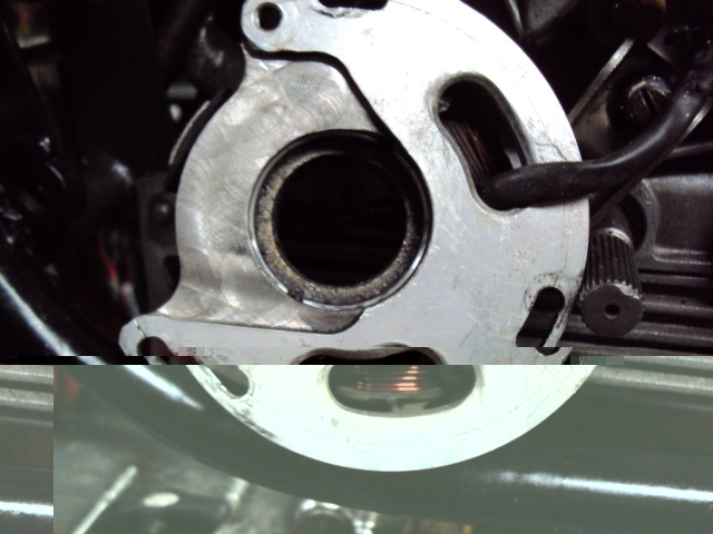

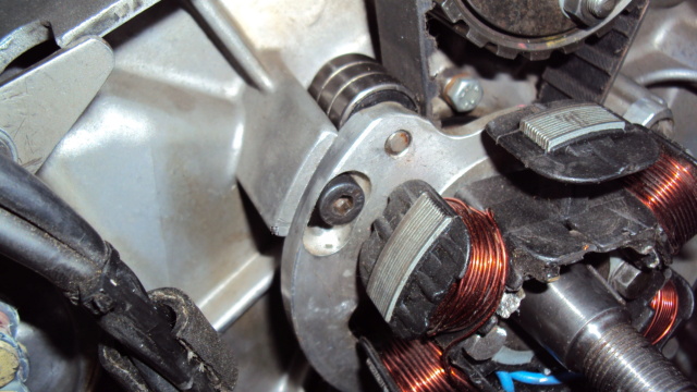

Years ago when I improved a 350 engine for races I made a new alternator plate to fit a belt tensioner to prevent belt slap . And I also changed it to fit an other type of alternator .
Than that was working really whell .
Photo ,
Here the back of the plate
Plateau prevu pour un tendeur vu de l'arrière.jpg (111.5 KiB) Viewed 357 times
And here the belt tensioner .
plateau alternateur avec tendeur.jpg (122.84 KiB) Viewed 357 times

Clever! But if you buy a properly sized belt, and it's not ancient, it wont sag or 'slap'.
I wonder how much power you lost for racing, dragging the belt over that unnecessary tensioner?

But I would say why I did this work . When I have a bike that I do not know when the last service was done I always change the belt .
And for a road bike it is ok if the belt has a small slap .
For the races when I tuned the engine I always used new belts . But sometimes the belts don't always have the right tightness and they slap .
On my tuned engine as the ignitions captors are on the camshaft when the belt slap the ignition timing is not perfect betwen 5000 - 9500 revs and this is why I made a tensioner .
And every times when I change something or when I adjust the belt tension I do it on the dynamometer .
Concerning about having an idee of the power here is a small video on a French track and it is between a honda 500 and my 350 . The action is more or less at 8"50 min . I hope you enjoy it .
