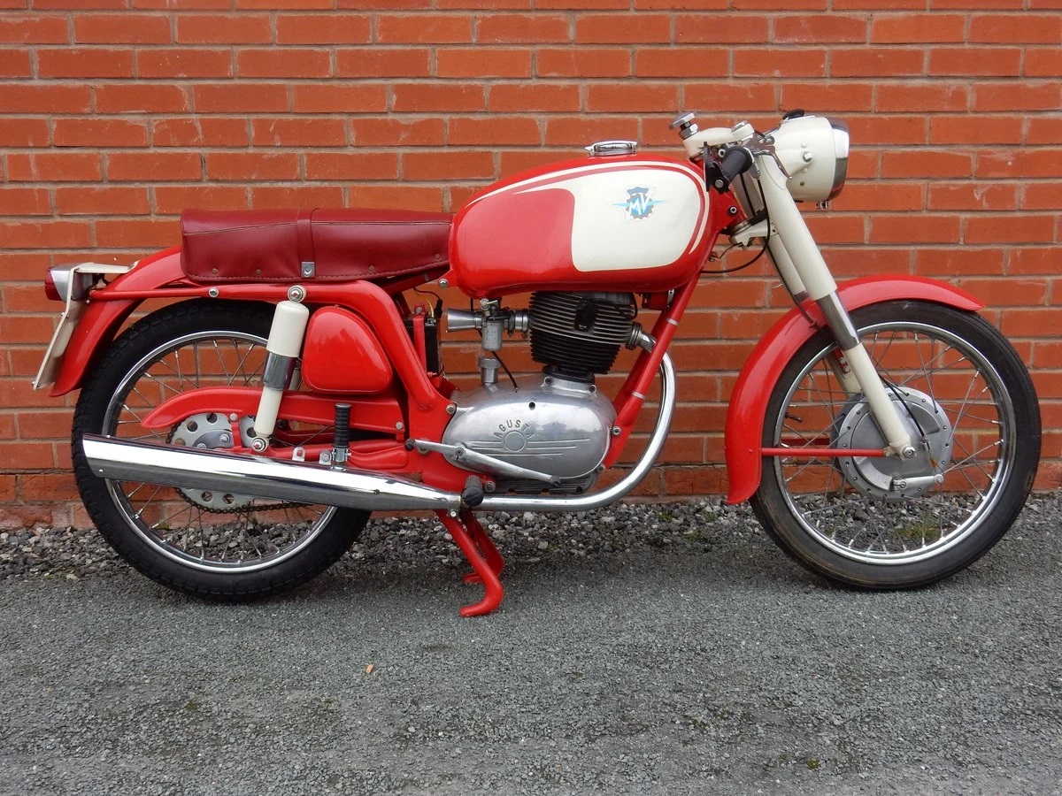

If the red stripe on the tanks matches the other red paint, then it makes sense to leave it as it is. Putting on the Moto Morini decals will make a world of difference.
The best thing to do is to bolt the bike together and see how it all looks. It might look perfectly fine, if a little 'different'. I've attached a couple of photos which offer a bit of a hint...
