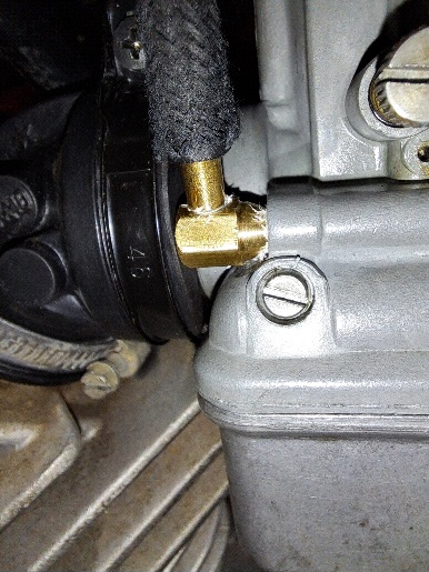

It has VHBZ carbs and has new rubber manifolds that I have fitted but not sure where the balance pipe would go, this would help me greatly if it had that, yes it does have a tail piece

Hi Barney,
Please see photo, the tube running up under the tank connects with the other carb. This is the balance port. If you look at the inlet rubber there is a boss where a hole was drilled on earlier bikes to put a takeoff for balancing. There was a mushroom shaped piece of metal that filled the hole when not in use.
Posts: 1680
Re: low to mid range flat spot
The balance ports Mickey refers to are on the carbs, not the rubber inlet mounts. There is usually a rubber pipe connecting one cylinder to the other, but they may be blanked off by a previous owner.

Thanks for the picture, these don’t appear to be on mine
Blooming 'eck! Italian manufacturing!
Try doing something on the intake rubbers. I've seen a take off fitted from the inside glued in with a screw on cap. I think it is essential on a Morini.

I’m working on the carbs at present, they will have vac ports by the end of Today, Thanks for the pics
