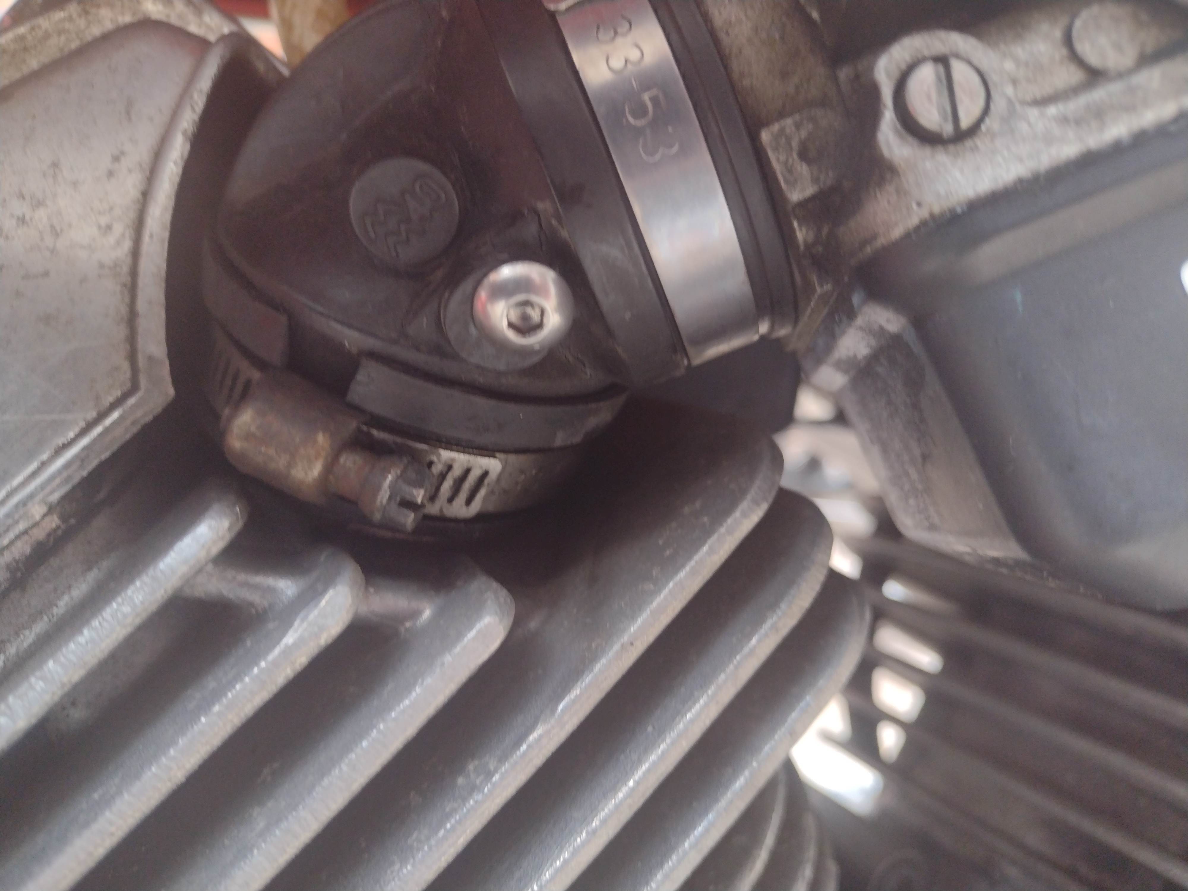

Being the bodger that I am, I just drilled holes in mine on the 375 that uses PHBH carbs with no balance pipe. Sealed with a stainless steel dome head socket head screw. M5 if I remember correctly - I can check. The OEM rubbers had natty stepped 'plugs' but I assume these are unobtainium.
The drill needs to be small enough that the screw actually has to be screwed in rather than just pushed (they sort of cut their own thread). Surgery performed too long ago to remember the exact size drill I used.
Never had any problem with them working loose or leaking air and the adapters that came with my (modern) Carbtune work well in the 'holes' too.

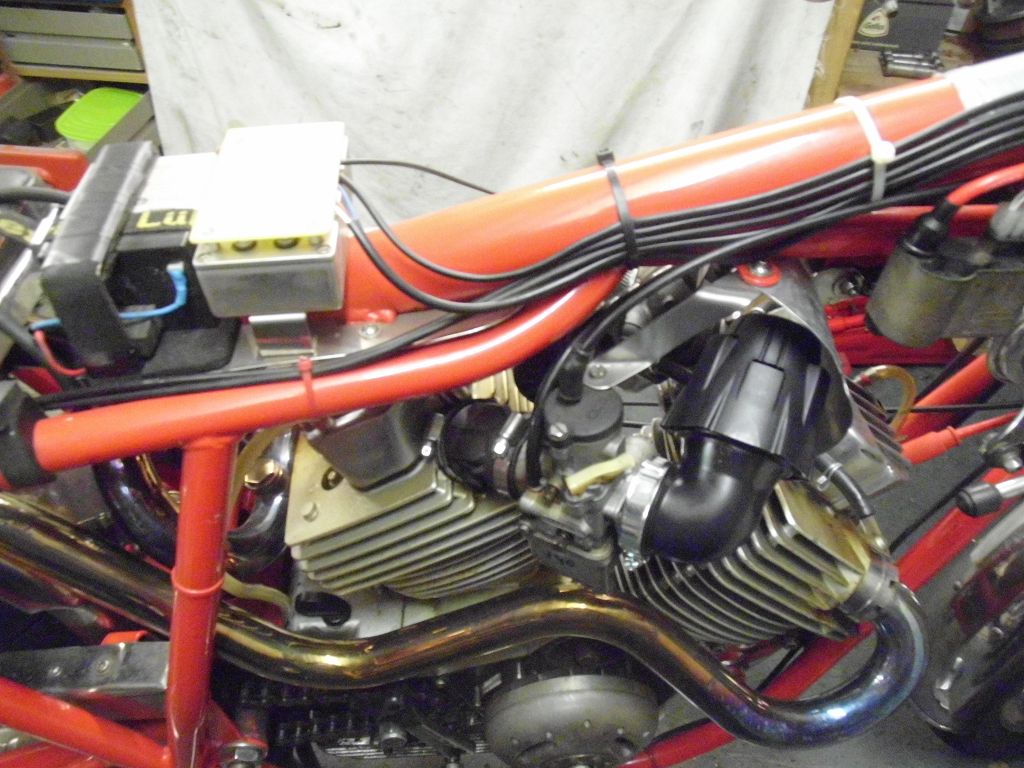

A picture is worth 1000 words. Definitely M5 - drill hole smaller than you would for tapping in to metal though.
I find 'close but no cigar' by ear and feel. Good enough for sure, but when you get those carbtune columns dipping together perfectly given a whiff of throttle I reckon you can feel the difference on the road.
You can probably drill more accurately in to the centre of the 'boss' than I did. I'm not a great one for immediate appearance over underlying form ;)

Posts: 1568
Re: Connecting Carbtune Manometer to Inlet Manifold
Aha. That photo reveals some incipient cracking of the rubber. Almost certainly due to having no air filter box, S&B cone filters and big zip ties to take the strain. One day I will get some proper high tech supports made. Then I dare say this set of rubbers will "see me out" ;)

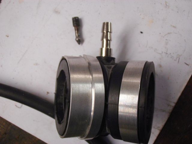

I´ve done that the same way as 72 degrees and it worked without any problems for years. Just make sure that the screw does not enter in the manifold canal. If I rememer it well, I´ve added an O-ring underneath the head of a simple allen screw.
There are some special "plugs" to seal the hole in the rubber. But I prefered the solucion with the screw :wink:

I think I'll buy a 5mm leather punch and drive a hole through the rubber manifold. As shown in your pics above, Morini conveniently provides a 'boss' for this moulded into the rubber. I can use this to temporarily insert the brass fitting for the Carbtune.
Afterwards, I will seal it with a 6mm rubber blanking plug (thank goodness for ebay...)

If would prefer drilling. If you use a 5 mm drill, the hole in the rubber will be quite less than that 5 mm. It will be dificult to enter a M5 screw or adapter. But it will seal very well. I don´t remember well but think that at the end I had to use a bigger drill than the thread of the adapter :wink:
