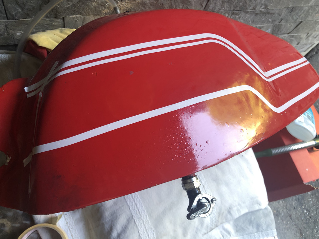

Hi all. Update of Camel story. The bike now runs well, but still miss the graph on the tank.
This my the procedure I used:

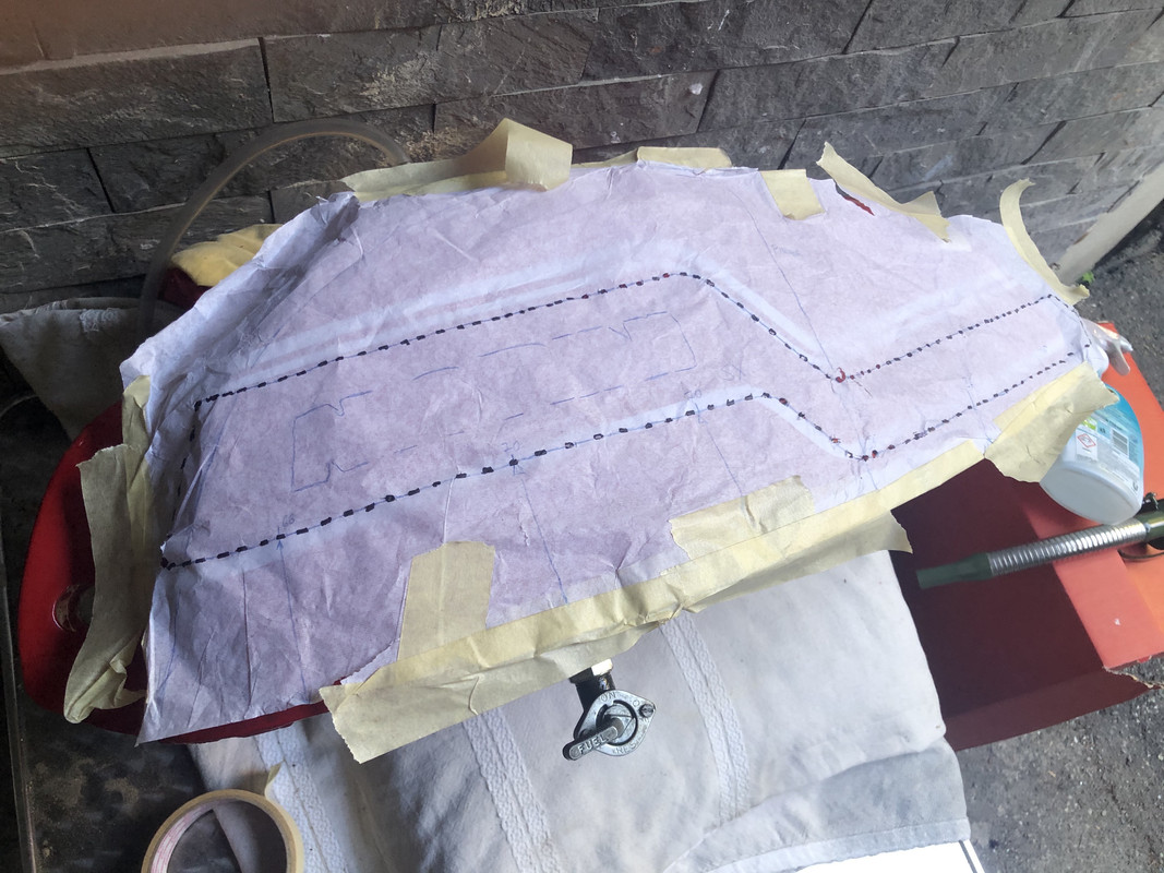

1) To draw the shape of the white zone, using a light paper and mark on the tank through small holes. I used a black marker.

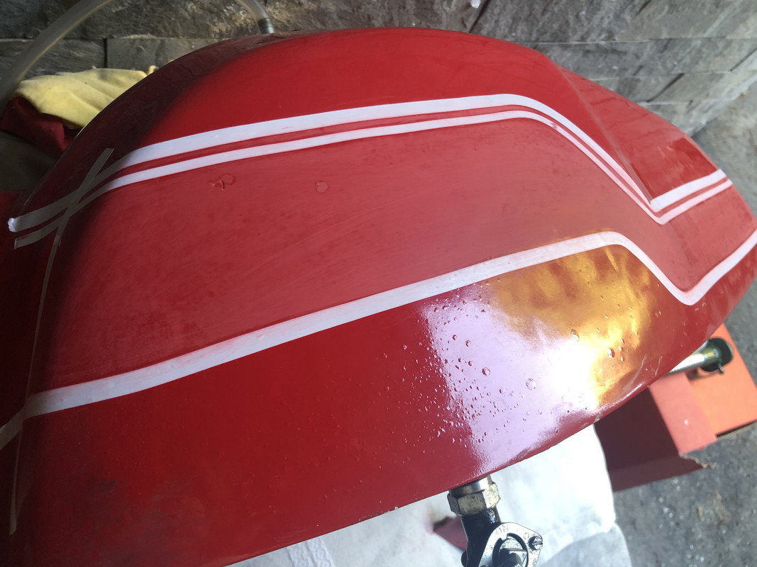

2) Following the marks I glued the white adhesive tape. It's a special tape that can be bended and curved; the same used by coach builders to paint the car body.
3) Then I scratched the surface to be painted using an abrasive 360 grade. This is necessary for the paint to cling.

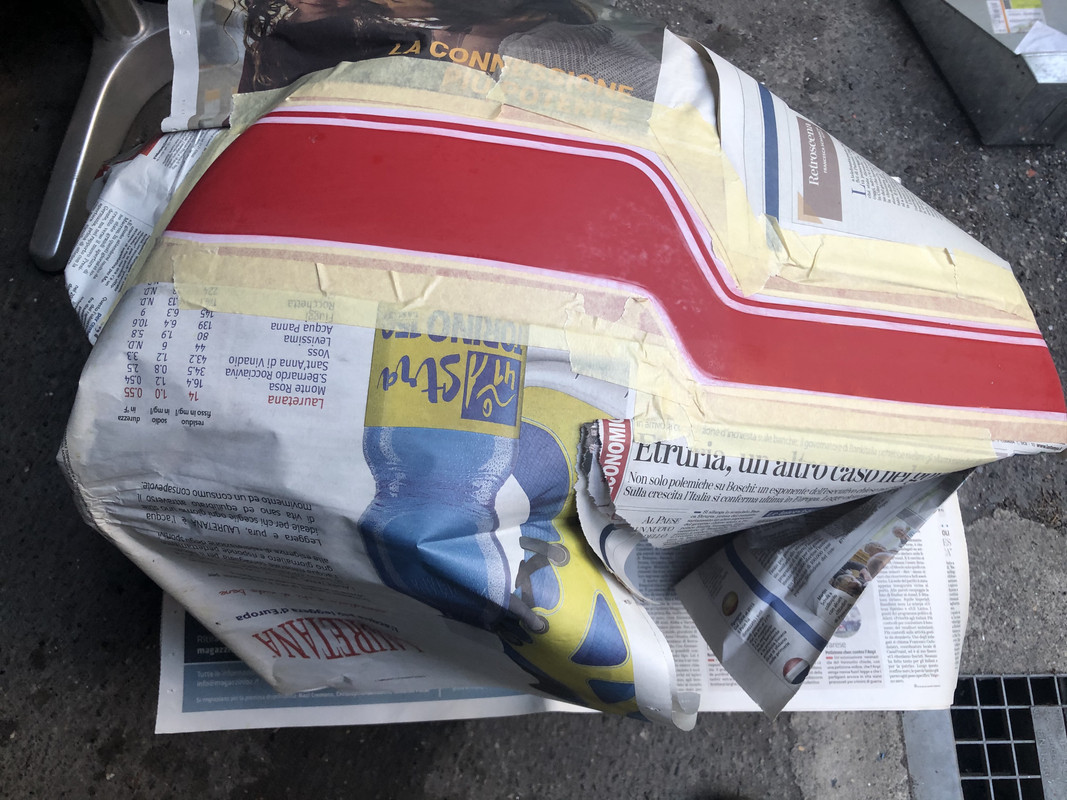

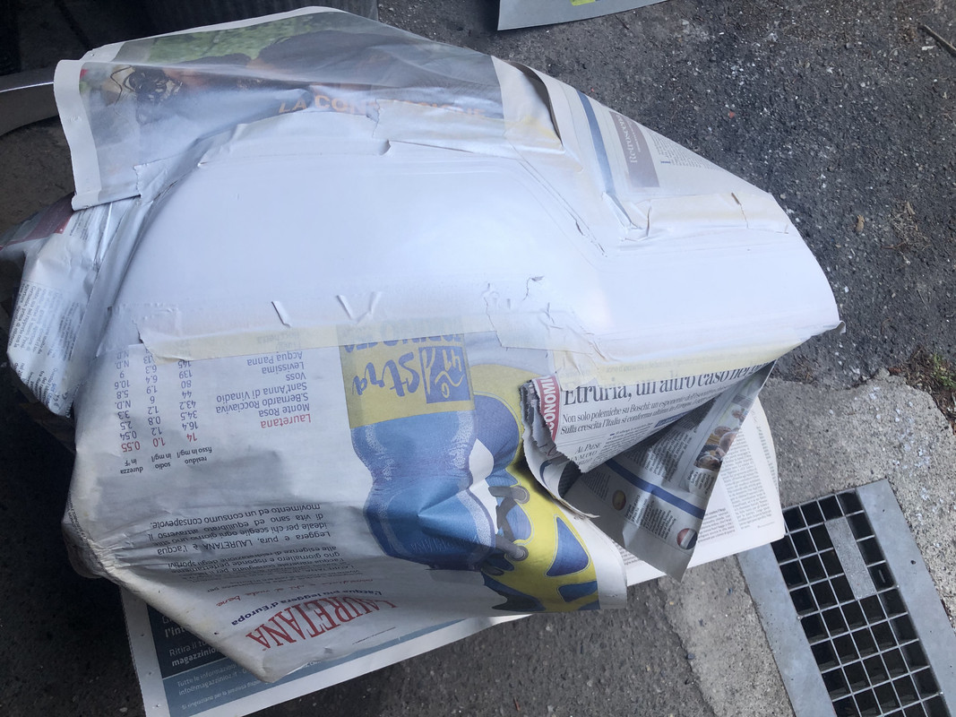

4) The rest of the tank must be covered. Important process because the paint goes everywhere.
5) Paint sprayed. At least 3 layers.
6) Protections and tape removed after paint got dry.
... follows ...
... follows ...

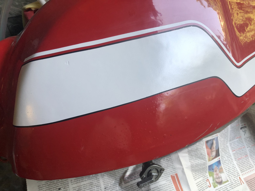

Re: 500 Camel mk1 - short story of a recovery

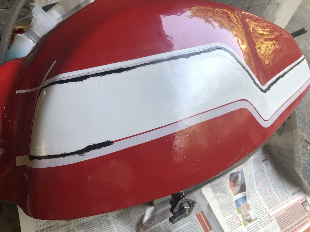

7) To do the black border, I had masked the white contour with tape and painted with a brush.

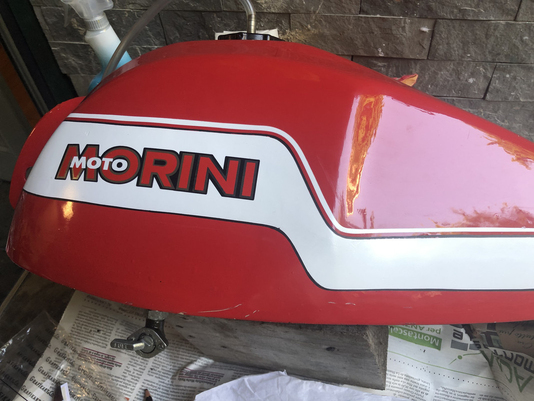

8 ) After drying, remove the tape with care and this is the final result
9) Last, logo application.
There are still defect of the original red paint, but I wanted to leave it as was, with its original paint.
Now I am thinking to apply a transparent glossy paint, to protect the tank.
Looks fine to me. It's an old bike with an old tank, why shouldn't the old paint look a little weary?

Good job there !
Yes, I deliberately left the old original paint.
