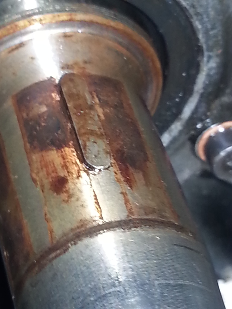

Re: crank too wide??
Post by Haboola72 »
Looks OK to me.
Here's the end of a 501 crank...not very clear I'm afraid.
Paper gasket between the cases?

Haboola72
Posts: 95
Joined: 05 Jan 2013 15:03
Location: Tarragona, Spain

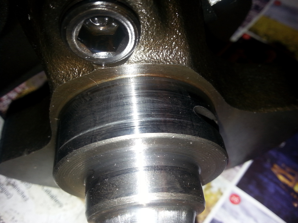

Post by Haboola72 »
Heres a better picture.
A clear witness mark of around 3mm?
I can't measure it as it's off being ground !

Haboola72 wrote:Heres a better picture.
This looks a lot like mine. if this works okay than so should mine I reckon?
@George 350, what do you mean with the steel 'keeper', is that the ring againt the roller bearing in the left?
Btw I measured the distance from end of crank toward pulley from this one and one from an engine lying around and it's the same, so it should be okay I think. Still the pulleys aren't exactly inline.
