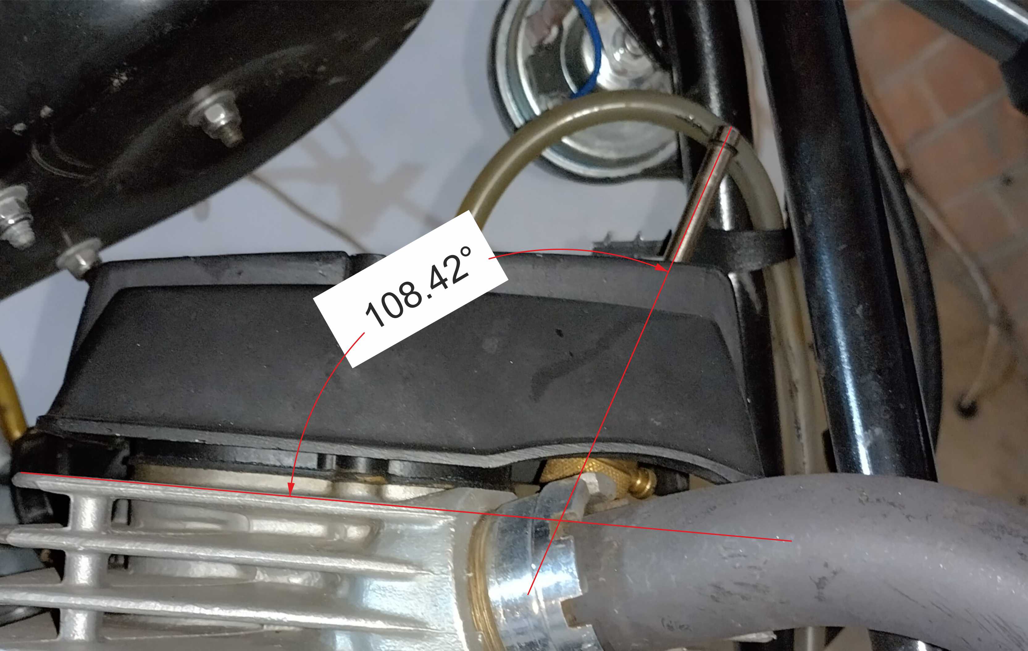

A bit late but...
I had the plug out of my 250 2c and used a piston depth gauge. Photo and some CAD for the following:
20251114 Plug to head angle sm.jpg (355.73 KiB) Viewed 1188 times
There will be some inaccuracy due to drawing the lines and parallax with the angle I held the phone at, but may help someone in the future.
