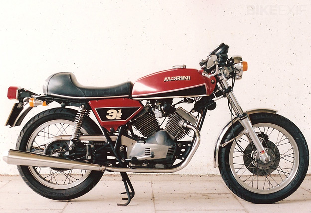

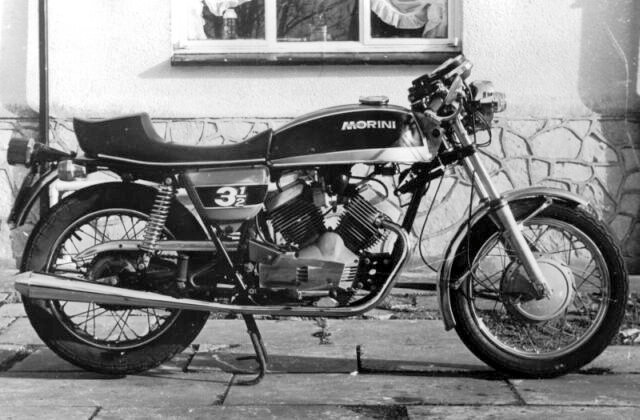

I noticed that the original sport seat on my bike does not seem to be the same shape as the sport seats that I see around the forum. The following two pictures shows the difference :-
This seems to be the most common sport seat shape that I see and also seems to be correct for the 1977 year.
The seat in this picture is off the earlier model sport (ser 1)as Norbert said
This seat shape is the same as mine but appears to be on an earlier bike.
the seat on this Strada is for a sport with mag/cast alloy wheels c.1979 to 1981'ish [
Can I ask if anyone knows which seat shape is correct for my bike model and also what other information you can offer as to the seat shown in the black and white image?[/quote]
Believe none of the seats in the photos above are correct for a 1977 spoke frt disc model

I think it's fairly well established that 1977 was the year that cast wheels were introduced, wire wheels and discs were just for the 76 season.
That's just PRODUCTION year, which has little to do with registered date and nothing to do with special orders, dealer modified machines or anything that's had parts swapped over time!
The OEM seat manufacturers, NISA, currently list just three seats for the V-twin Morinis; The original short Strada seat, the round tail Sport seat and the 'square' back seat.
The ready availability and reasonable price of the round tail Sport seat, along with it's aesthetic appeal to many has made it a very common choice for replacing a worn original, rather than getting a seat recovered.
The square back seat, although listed, appears to only be made to order. NLM said they couldn't obtain them, but Wolfgang Tritsch had a batch and I just bought one from an Italian source.
My Sport from 1977 (good estimation from frame number) has the ridge down the centre of the tank and had a square back seat, just like the brochure.
