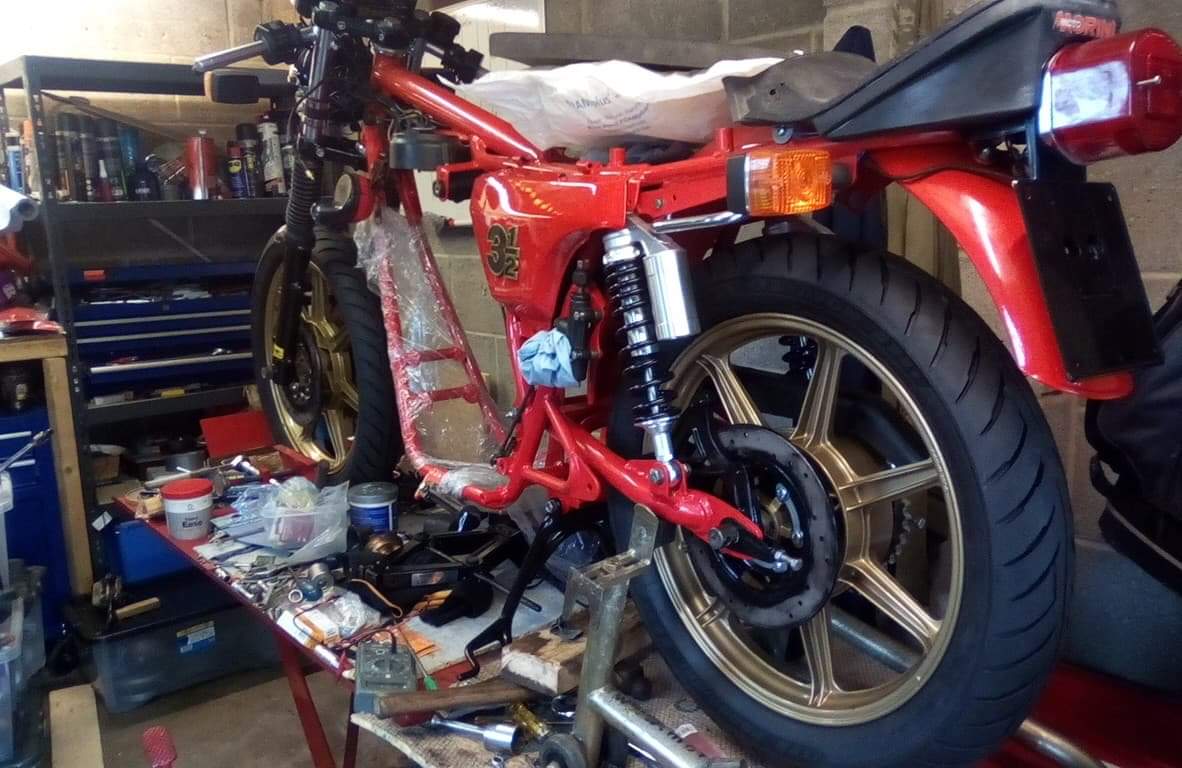

Re: Winter 2018Rebuild
Update -
It looks like a motorcycle now.
acemorini
Posts: 333
Joined: 11 Sep 2012 13:49
Location: buxted east sussex
Post by acemorini »
Looking good Mike.
Thanks. I'm taking my time as I wait for the crank! Hopefully the shells will be in this week.
