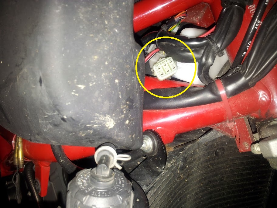

hi gianni,gianni wrote: thinking about connecting heated grips anybody know where the original cabeling or connectors are
I only found ons connector with tree cabels in it (under the controlpanel) is this the one or are it two independent ones?
you will find the connector behind the ride fuel tank cover. i hope my photos can help.
günni
- heizung7.jpg (114.82 KiB) Viewed 13551 times
- heizung1.jpg (197.54 KiB) Viewed 13551 times

thanks a lot !!!
I have a pare of aftermarket ones (oxford) connecting them tho these plugs with this info is easy
In this I can use the standard button than to controll them
Aftermarket and original ones both work on 12V so I don'think this will give problems
