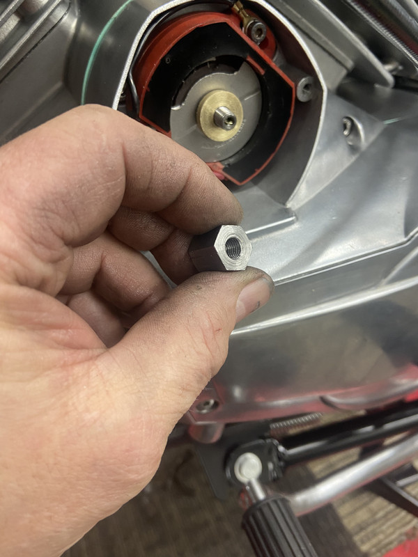

I was able to make a new special nut from round stock rod, lathe and miiling machine time
to make the square slot I found a great Youttube video, cut a slot along the length the width of the tach drive; 3mm and cut the depth to the center plus 1/2 the width of the drive, in this case a 14mm nut size so 7mm to center plus 1.5mm for 1/2 the width of the drive for an 8.5mm deep cut. Then use a 3mm drill bit as a spacer, srop in a 3mm wide plug and weld it in, then resurface in the mill
7mm x 1.0 internal thread
I made a new brass cupped washer as well, it was missing too

Yes a brilliant piece of work and quite an inventive way to do it
and thank you for taking the time to describe it and up load the pictures
A question:
how did you decide about the length of the nut as you don't have a prototype to copy?
I guess so long as there is sufficient clearance all is good.
I could measure one for you if you like.
For the benefit of others reading this thread in the future.
The cupped washer is very important to properly fix the rotor,
without it the nut would bear on the soft aluminium core and
the rotor will be damaged.

A question:
A lot of measurements using the depth gauge of a caliper and then trial fitting by leaving the 90 degree tach drive off the cover and recording the clearance to the cover face then subtracting the protruding reach of the tach drive bolted into the cover, a few fine shaves in the lathe and I think I got it. The brass cup washer I made has a thicker depth so the nut I made would probably be too short with a stock cup washer.
