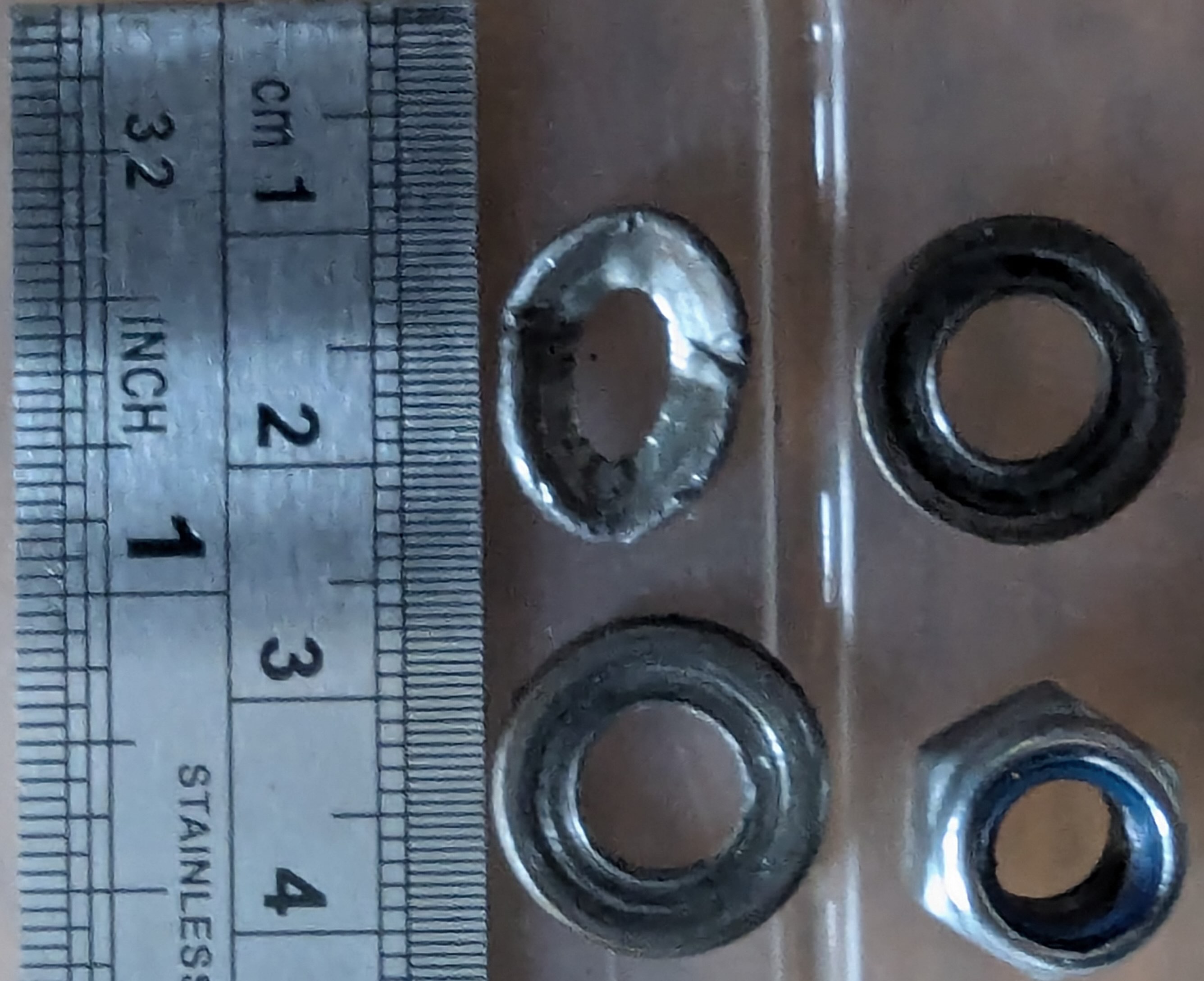

I've taken some measurements of the damaged washer and the M7 rocker washers. I used a low cost but reasonably good micrometer, the rule is to help show scale on the photo. All measurements are approximate owing to the limitations of the measuring tools I used and my abilities in using them.
- M7 rocker washers are: 14.2mm OD, 7.0mm ID, 1.4mm thick. Measured difference in radius 3.5 to 3.7mm.
- Damaged washer's dimensions have mins and maxes because of the oval shape of it: OD max 14.3mm min 10.5mm, ID 4.1mm to 7.1mm, thickness varies between 1.3mm and 1.7mm, most of it is 1.4mm. Measured radius 3.3 to 3.4mm.
Visually the damaged washer has a different profile; as Mark observed the M7 rocker washers seem to have a bevelled edge, this washer doesn't have the same profile. I'm leaning to it being an M6 washer rather than one of the M7 rocker washers but not 100% confident in this assessment. I've found standard dimensions for M6 and M7 washers online e.g.
M6 A2 OD = 12mm and
M7 A2 OD = 14mm on the accu.co.uk website.
- damaged washer compared to rocker m7 washers.jpg (503.34 KiB) Viewed 9321 times
