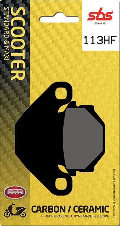

As for the SBS 113HF pads? I attach an image from the SBS catalogue and they are supposed to be for a Malaguti F10 50cc scooter, a Peugot SV Roland Garros and Sport, both 50cc scooters and all made 1992-3. I am not sure why your German supplier suggested that these will fit. :? Hey ho, time will tell.
If after discussion with my supplier,we arrive at a satisfactory resolution to this conundrum, I'll post up their details and fore warn them!
