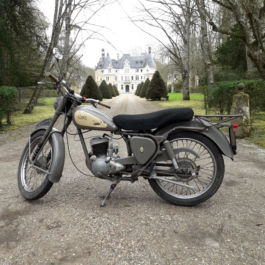

I have indeed. 'Found ' some years back towards the east of France. I think it had spent most of its life in the local vinyards, judging from the baked on oil and sand mix which covered the engine. A broken Reynolds chain put it out of service, when no replacement would have been available locally.
I have only reassembled it, cleaned and sorted a few things. Paintwork is wonderful (apart from various dings), I only changed the original tyres yesterday...
Here it is near a local Chateau.
