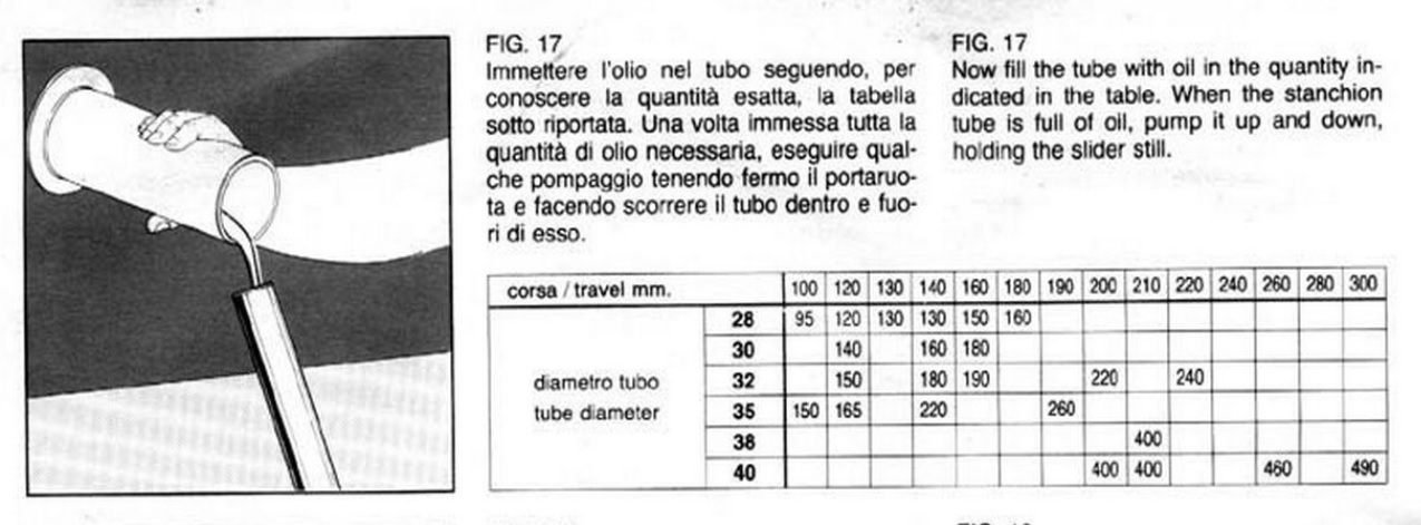

Hi does anyone know the quantity of fork oil for a 125 corsaro country

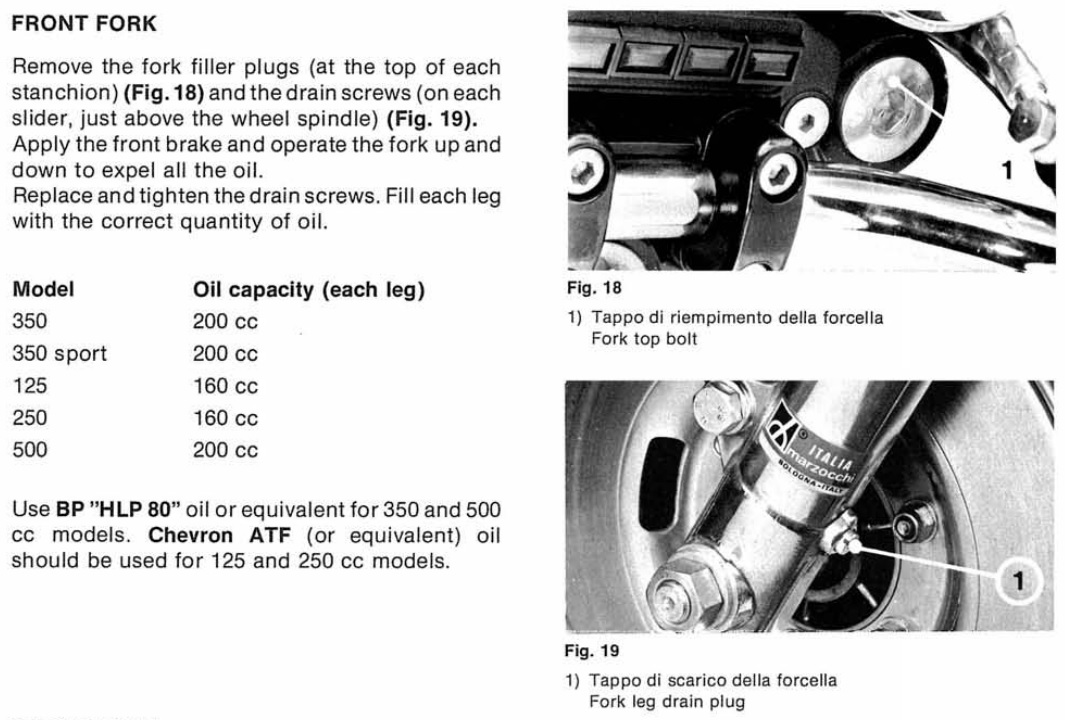

As you know, there doesn't appear to be a manual or very much information at all, available for the Corsaro Country.
Still, I would suggest you start with 160cc of 10W oil per leg and see how you go.
The Country fork legs are 32mm and 125H fork legs are 30.75mm so the figure of 160mm is deduced from the Marzocchi Manual and the Morini Blue Book.

- Marzocchi Manual Fig. 17.jpg (148.23 KiB) Viewed 793 times
- Blue Book Page 21.jpg (193.6 KiB) Viewed 793 times
