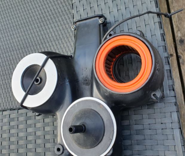

Steve, tried-them-all has a twin shock like mine. You can see it here viewtopic.php?f=8&t=6785
My airbox was in about 10 pieces when I unbolted it. I found that Marley gutter adhesive worked really well at "welding" it back together. It's a terrible design really as you need to remove the whole box to check or replace the filters, so I cut out the filter chamber lids and glued them to some aluminium disks which are then held on with rubber bands ( the old airbox seal) next I glued both halves together and filled the gap around it. Now I can just pop off the tank, and easily check or replace them.
Air filter box.JPG (65.4 KiB) Viewed 7489 times

That's a great solution to make the filters easier to change and the air box more waterproof for off road etc

Kamel wrote: 03 Nov 2021 17:55 Steve, tried-them-all has a twin shock like mine. You can see it here viewtopic.php?f=8&t=6785
Thanks Cliff! Good design that too. I have gone back to a standard airbox recently, mainly because I was finding too many fords where I was worried about the water level being too high to risk with pod filters. Now it's back at the standard inlet height I'm more confident going through deep water. If it gets high enough to trouble that airbox I'll probably be in more trouble already. :wink:

thanks guys for the pics, this airbox looks like it will fit the brackets, but i probably won't find one soon, so it may be pods as an interim. Is the same airbox fitted to all the 500s up to a certain year?
