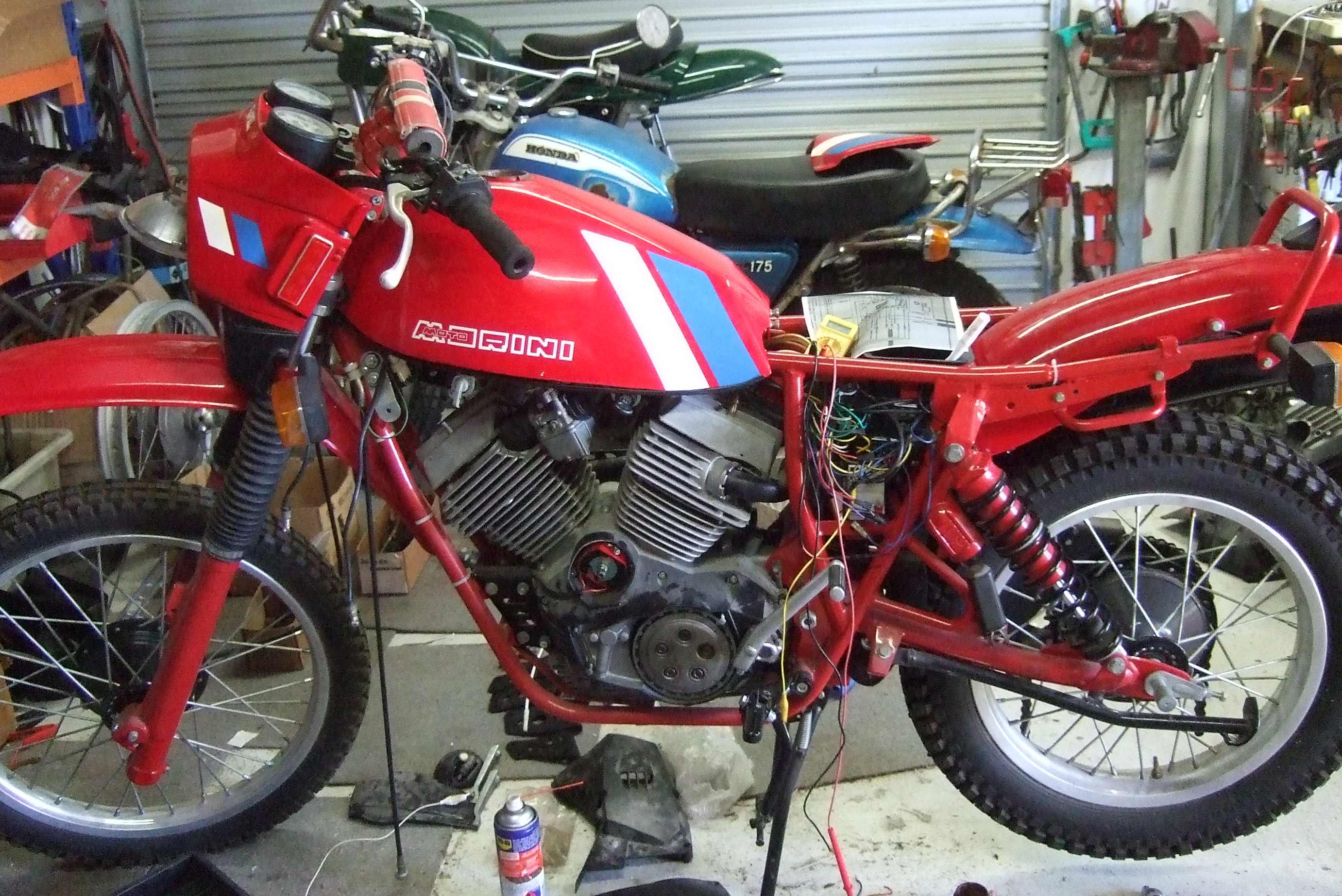

Just gettng my 1983 2nd series camel back together and my 1985 501 going again and I need wiring diagrams for both of them - any help out there?
phil in australia...
camel 500 and camel 501 wiring diags anyone?

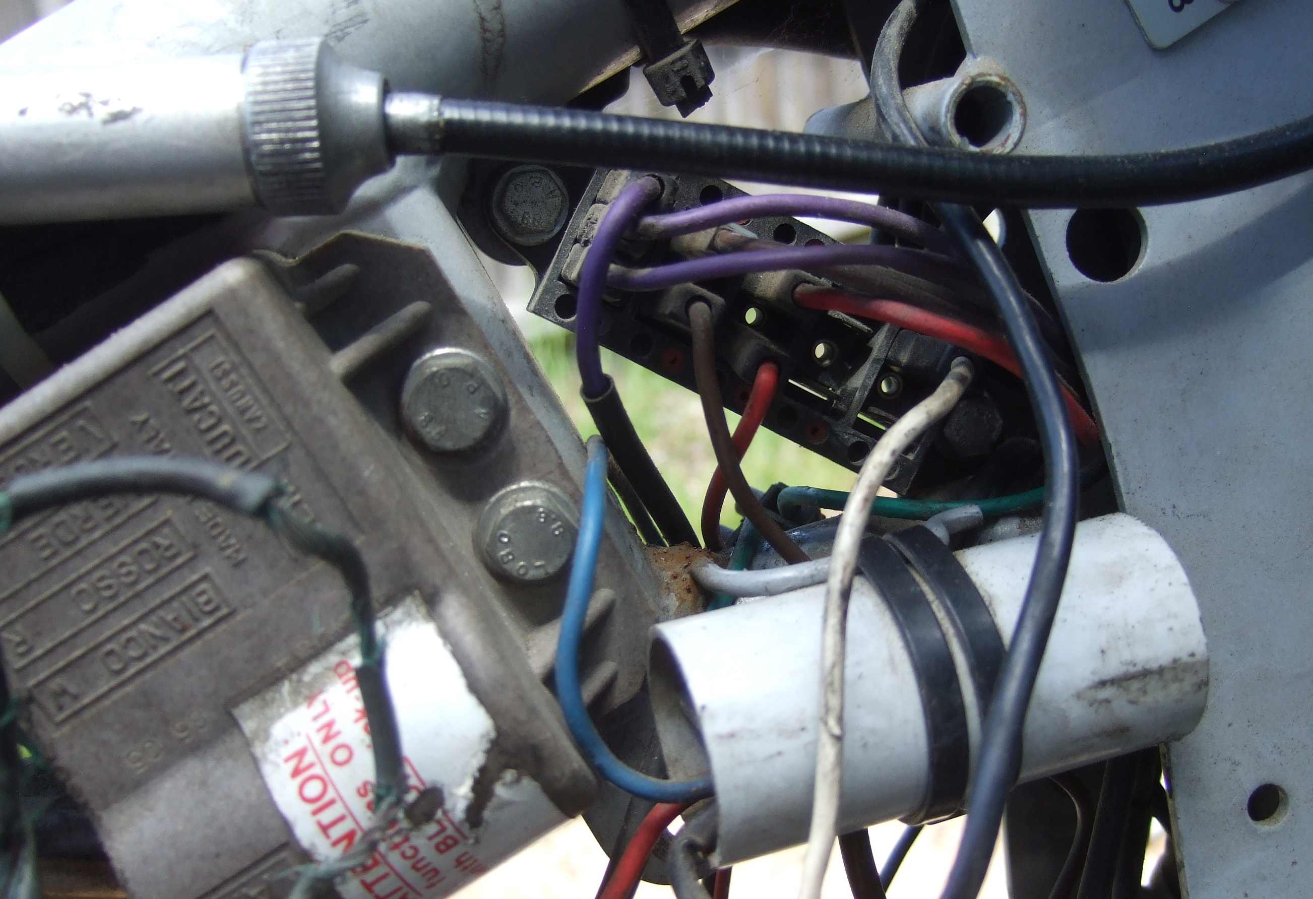

thanks for that, it is a help... it is certainly the correct fuse box wiring sequence as it matches the internal connections of my box - it's a pity the colour codes aren't clear..however I will get it done. Looks like on my model 500 camel Morini deleted the oil pressure switch (and warning light) and turn indicator light on the dash.
For the 501 camel I only need to know where the magneto wiring fits into this junction box...
also, do you know the correct amps for the fuses?
thanks
phil
thanks
phil

Hi, I don't have a 501 wiring diagram but I do have the remains of a 6V DC 12V AC wiring loom from a 501 Camel
The junction box spades are linked behind and from the left are arranged in clusters of 4-4-2
The wiring and ignition circuit is similar to the 500 Camel, use the same coloured wires and I have used a 500 Camel wiring diagram (and bike) as a guide for working on 501 electrics
White - Dedicated earth from the alternator stator to both transducers (coils)
Red - Pickup to transducers
Green - Ignition switch with diode in line
Blue - Frame earth
Looking at your photo of the junction box you have either two or three connections missing?
White wire missing is either from the stator or transducers
Check where the connected two red wires go to (pickup?)
As the ignition system is self generated and the connections between stator/transducers/pickup are quite simple and should be easy to work out
The ignition switch (Green wire) connection is a switched earth; if removed double check connections here as a DC current will toast tranducers
Yes, only the MkI Camel came with an oil pressure switch
Good luck, have fun, Ian
