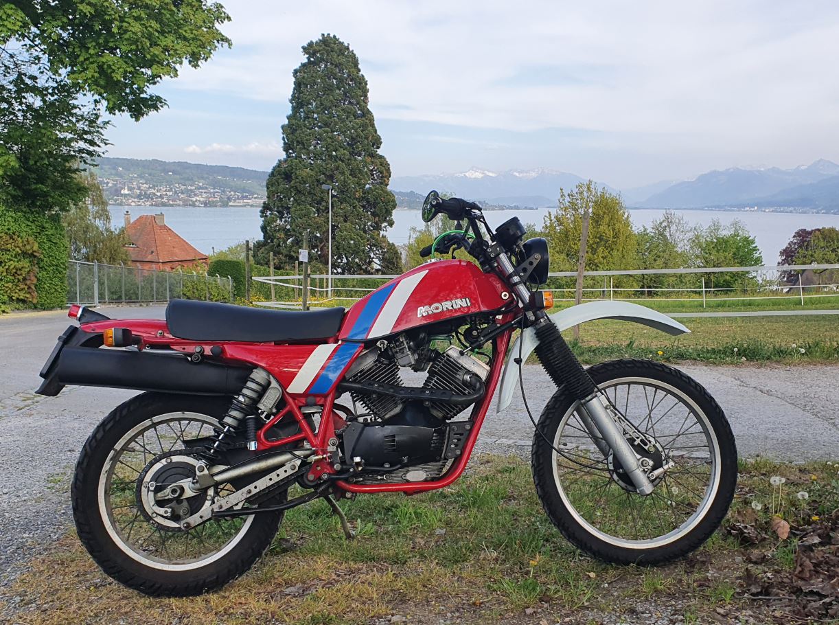

Re: Camel woodruff key
Hey Ben, apologies, I've been busy with other classic vehicle ownership issues.
Yes i believe that is the right way to read the dimensions.
How about posting some pics?
This is my recently completed Camel Mk2 (well I think it's a Mk2).... Cheers,
Kamel
Kamel

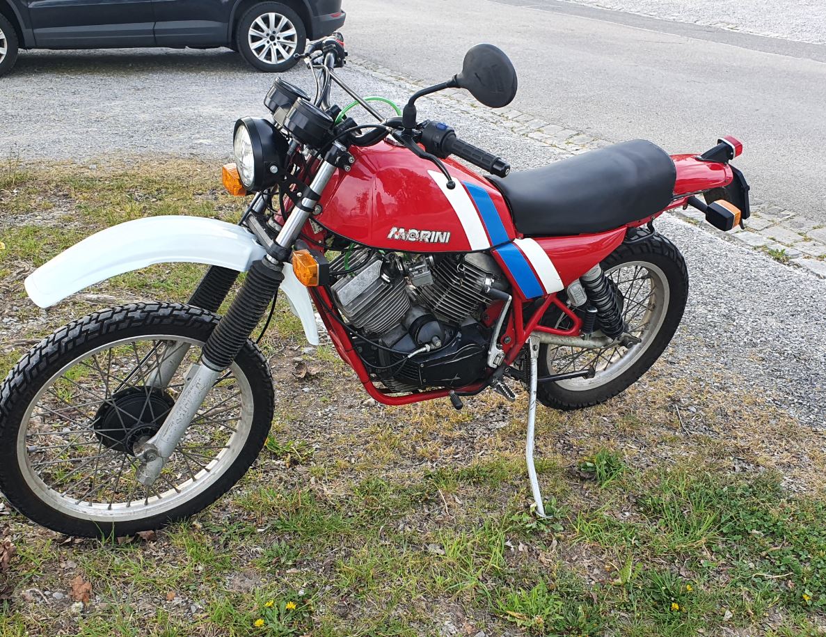

- Posts: 1566
- Joined: 12 Nov 2007 23:44
- Location: Leicestershire
Very nice Ben !
That a steel tank?
That a steel tank?
- Posts: 20
- Joined: 10 Aug 2020 04:32
- Location: California, USA
- Location: Southern California
Thank you! Yes, it is a steel tank... Ben
