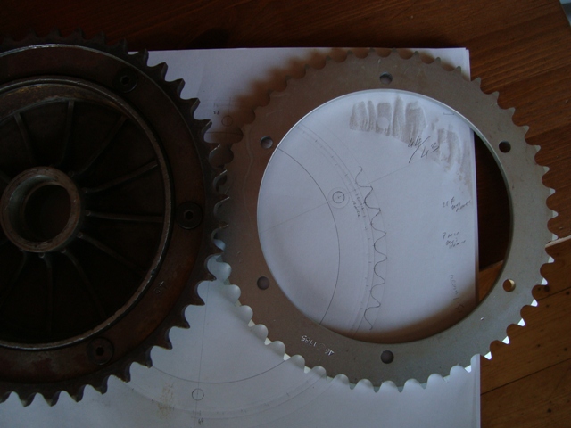

Hi Ross, I looked at this a couple of years back as I'm running standard 500 Camel 14/46 sprockets on my Camel fitted with a 501 engine (500/501 6 speed gearboxes have the same ratios).
But the problem is the chain clearing the rear brake drum.
There is safe clearance for a 45 tooth sprocket and a 44 sprocket might be possible but once things start to wear there might be contact with the drum on the raised castings for the sprocket screws.
The only real solutions for better road gearing on a Camel is either a different rear wheel (the 501 Camel wheel won't fit in the swinging arm) or a 500 5 speed gear box which has higher gearing.
Hope this helps and enjoy,
Ian

- Camel 46 sprockets (4).JPG (125.52 KiB) Viewed 8519 times
