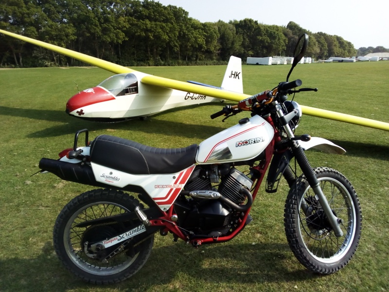

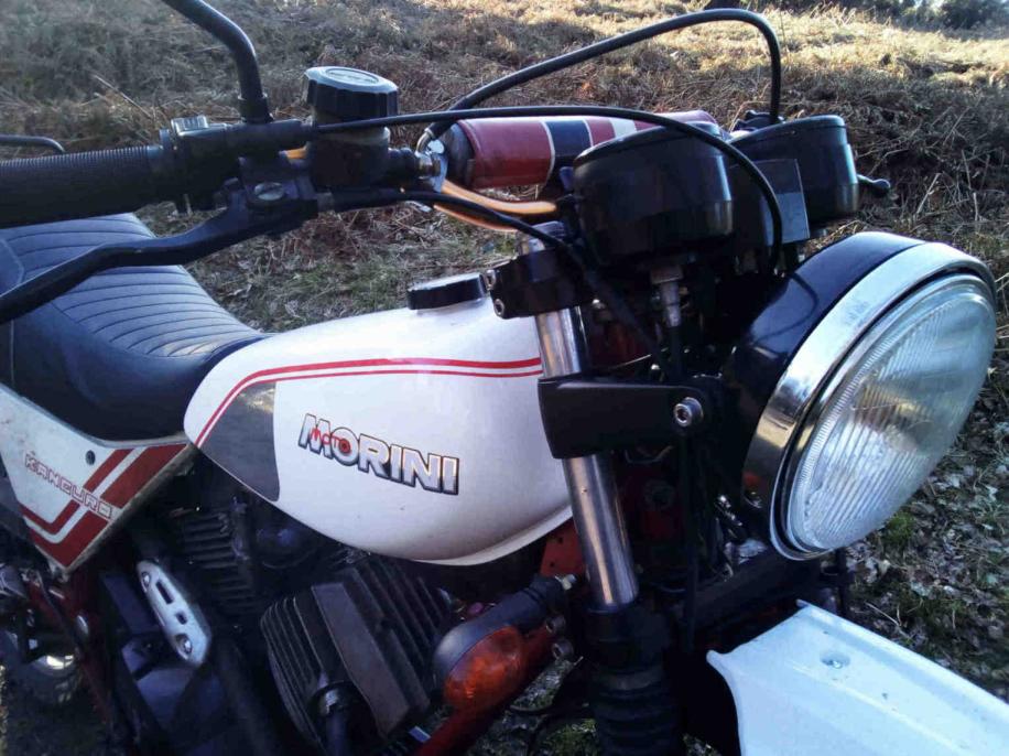

Hi Morini addicts,
Although familiar with working on Morinis (the missus has had a 3 1/2 since '89) I've never had one of my own until now, but I've always fancied a Vee twin off-roader.
I thought other owners may be interested in the result of a few months effort in giving my own recent acquisition a "light Refresh" after a few unloved years by the former owner........before
and after pictures below.
Work done:
12v conversion, battery free & with LED's.
New bars, mudguards -UFO/Acerbis Vintage, modern front & rear lights & switches.
Refinished XT250 fuel tank & mounts - the original had seen far better days and I like the 1970's look from an e-bay bargain.
Seat re-foamed/shaped and recovered. (I now know why previous owner had a sheepskin!)
Sidestand made & old welds/bent stand ground off.
Broken rear wheel spokes replaced.
Broken/welded Kickstart replaced.
Front brake overhaul & braided hose & new cables etc.
New wheel bearings & chain.
Air filter modified, unrestricted with jetting as 3 1/2 strada running 112 jets - now far more get up & go!
A bit of paint here and there, but done without stripping the whole bike.
Powder coating to gear change, grab rail, pegs and outer engine covers etc. & generally tidied up.
Service & belt.
TKC80 enduro tyres.
A fair bit of work, but I'm now enjoying it for what it was built for!

I really like the look of that, with the XT tank. I did many miles on my Kanguros, but always felt the looks were a bit too 'angular'. Hope you enjoy yours as much.

I wanted better lights, so I fitted a 12v boyer accumulator and a pattern RD 350LC 65/55 H4 headlamp. It's big but I like the look and works good.
Judging by all your kind comments, there'll be a few Kanguro owners looking for vintage XT or DT fuel tanks!
Bear in mind unless you move the transducers, the frame tunnel needs to be quite wide.
It sprung a major leak from the front rocker cover when out at speed yesterday though.
My waterproofs are now oily, and another job to do........
