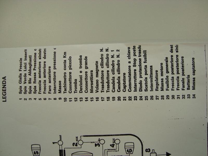

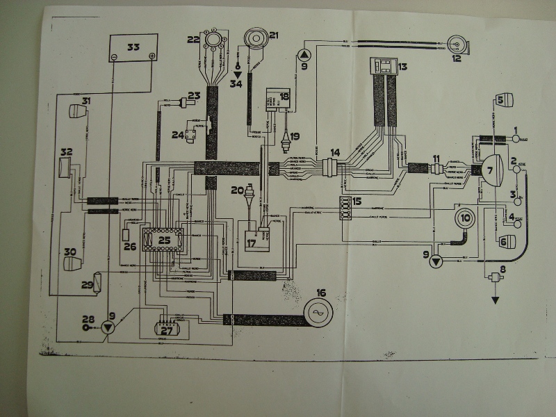

Meanwhile find attached a wiring diagram.
Have fun, Ian
Camel 500 MkI key.JPG (223.74 KiB) Viewed 12911 times
Camel 500 MkI.JPG (221.2 KiB) Viewed 12911 times

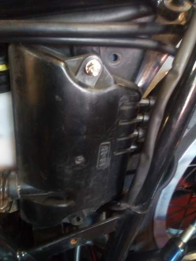

Hopefully this is the box you are talking about...
MM31?
Top two from the rocker boxes, bottom two vent, in my case to the chain for a bit of lubrication (hopefully, or not?).

Hi, looking at a Mk1 Camel breather box from the back of the bike: the 2 left pipes go to the rocker covers and the two right pipes go to atmosphere or in some cases to the airbox.
Like Mike I have the pipes leading to the chain (near the front sprocket).
Originally on the UK Mk1 the airbox pipes were simply attached to the top tube where they went to atmosphere and covered everything under the tank with a film of oil.
Enjoy
