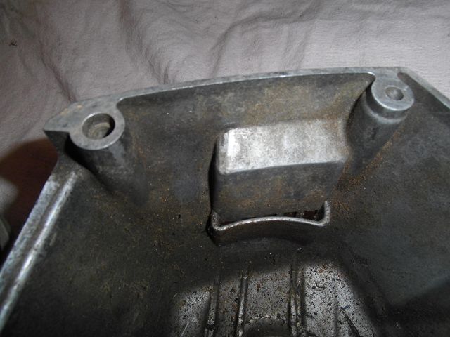

Hi, the MkI Camel alternator cover has is a plastic panel fixed inside with 3 pop rivets which blocks off the 5 front air slots.

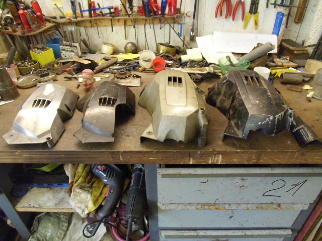

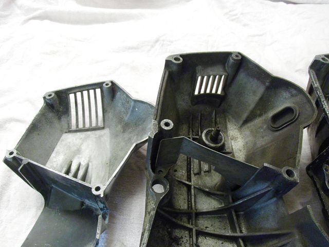

You will have noticed, that sometimes I tried to figure out some diferences of our spares and making some fotos of them. There is no sense doing this keeping it only on my pc.Mostly I published that fotos en La Sterga, our ATG. So here comes some of the stuff I found out about this covers:
I have or once had 4 types of alternator covers (the Camel MK1 obviosly missing): small and bigger ones (for the electric starter) for the street and enduro bikes (the enduro ones in this case are black) There are some other diferences but talking about the air entrance there are three types (plus Camel KM1). The small ones street as enduro have free slots. The big ones for the street models have the slots partly covered. You also can see, that all the samll once separeted the alternator and cambelt section very well The enduro electric start covers, at least the late X3 ones and as far as I know early Camel 501 and Excalibur with Ducati ignicion had the slot much more covered, without closing them. ciao

Very interesting gentlemen, thank you. Next time I have the cover off I shall inspect my slots!
