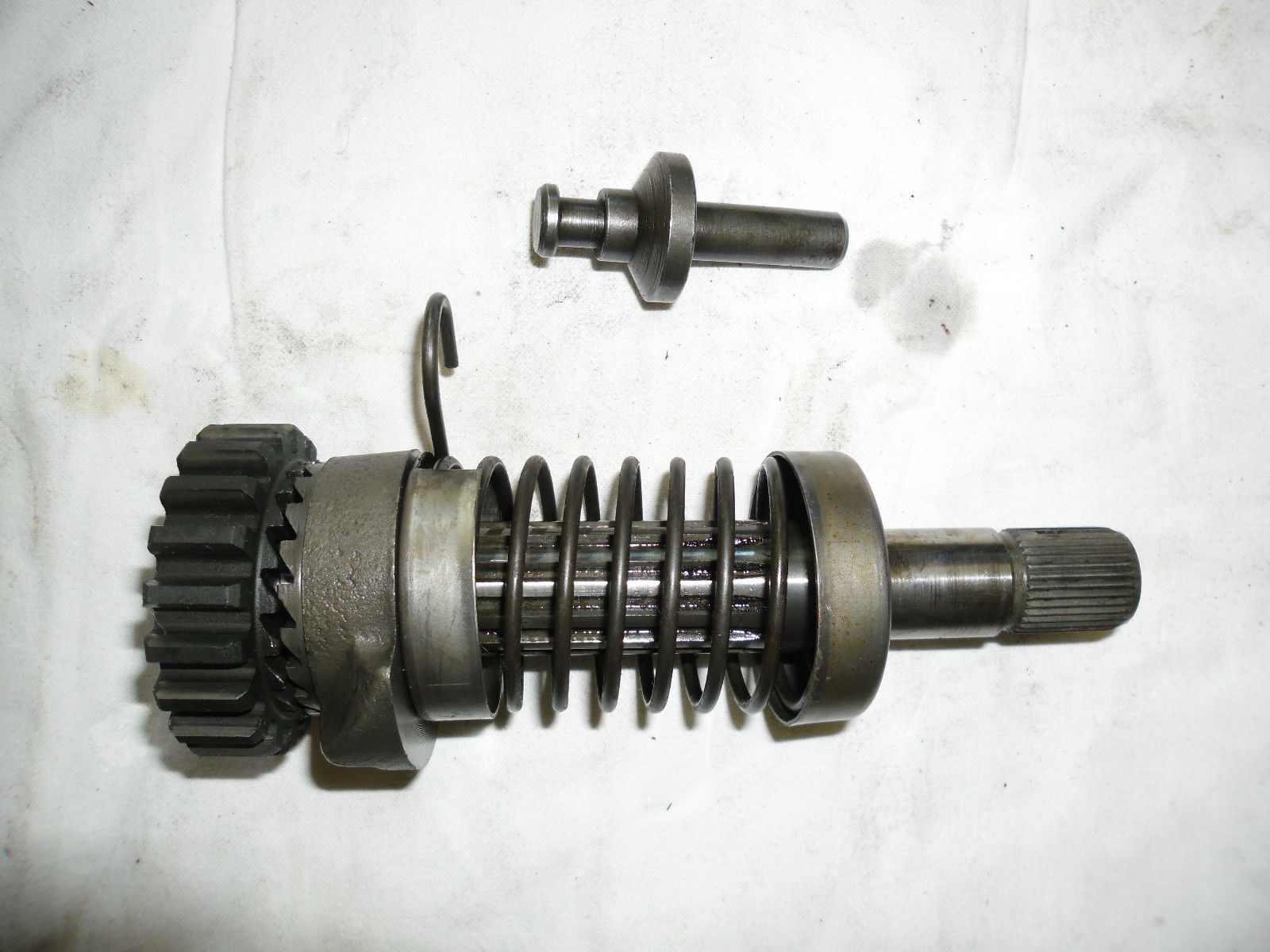

my camel was hard to start , i decided to have a look , and the kickstart cog is missing one tooth!
no wonder...
easy , go to the pile of junk, fit a 350 cog , but wait, they are different!
the 350 one has 20 teeth, the 500 camel came with a 19 teeth cog.
anybody knows if they are interchangeable?

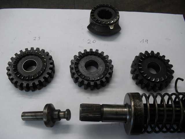

A few years ago I tried to figure out some of the diferences of the spare parts from the 350, 500 and 501 motors. Acording to the kickstart pinions I found out:
20 teeth: 350
19 teeth: 500/501 6-gear
23 teeht: 500 and 250 Single 5 gear
You can not interchange these pinios of the kckstarter mecanism beetween them because the pinions on the primary axle are diferent. The rest of the mecanism should be the same, although there are slightly diferences with the "helocial" (?) teeth. I don´t think that this has to do with the models, it seems to depend on production changes. You have to look for a pair that fits the best.

Thanks norbert!
that helps a lot, at least i know what i am looking for.

ok , so the 19 tooth sprocket is not available any more.
i tried the obvious suppliers , nothing available new or used
slightly frustrated i tried the 20 tooth sprocket, and it seems to fit perfectly
so that is what is fitted now.
