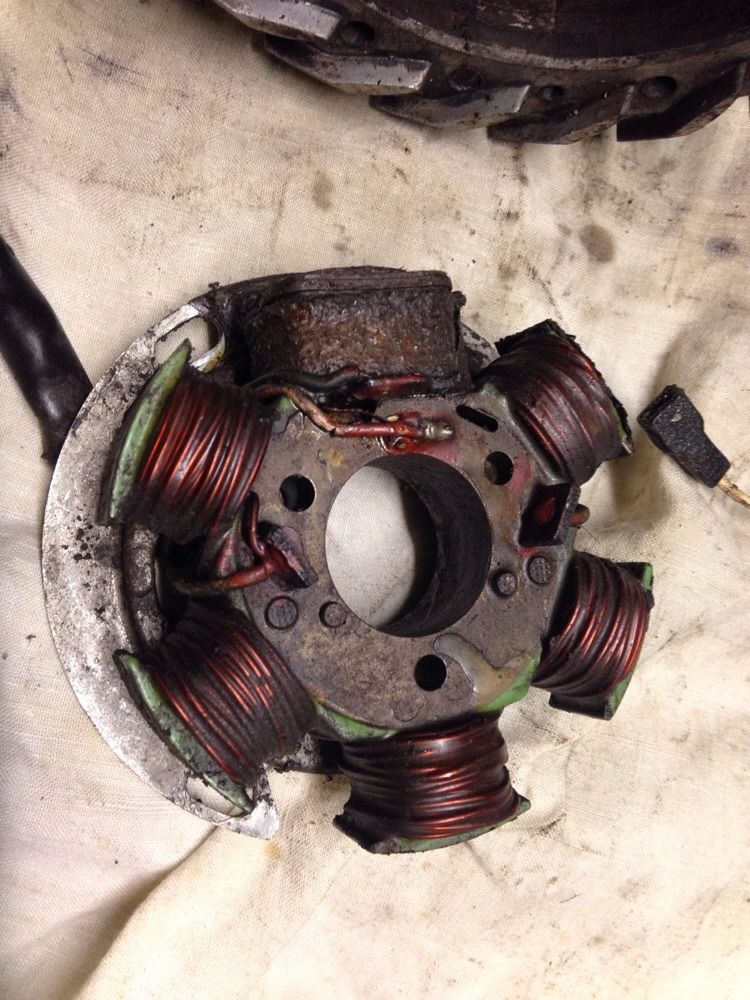

You said that the winding of the light coils (not the ignicion one) look like handmade. Is the wire put directly on the metal nucleus without any plastic body (like the ignicion coil) and looks like a child had done the wiring? Then you have the strongest last generacion generator with about 200W! As far as I know the X3 Kanguros do have these generator (like for example the 501 that still do not have the kokusan ignicion). These generators require another regulator as the older models. I don´t know much about electric stuff (to be honest nearly nothing :oops: ). But with this generators normaly you won´t have problems to charge the battery for the electric starter :)
körperlose Lima.JPG (136.42 KiB) Viewed 33407 times

Yes, Norbert, you're correct and you've aptly described the way the coils have been wound - particularly as mine seems to have been rewound fairly recently by hand. My coils, unlike the ones in your photo don't have the protective resin, and the way the windings have been done indicates it wasn't done with anything like the consistency or precision of the factory (even if their's also look amateur :)
Because I've got the latest type (before the Kokusan) which gives the higher power output I've not wanted to try the older stator I've obtained. It's the split windings type from an earlier Kanguro. I like my bike to have 'enough' power to keep the vast battery charged and so I can add some extra LED spot lights lights for riding in the dark (autumn and winter are never far away). The older alternator might still be sufficient as Kanguro's only have a 35W headlight (mine has a different headlight unit which still uses a 35W/35W headlight bulb) however this way I've 'enough' not to need to calculate whether power available is greater than power needed.
