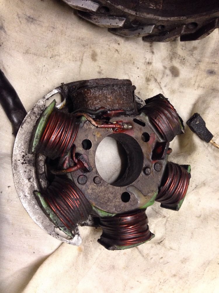

A quick update. The bike stopped running after a ride to London and back, I'd ridden about 30 miles in, and 25 miles home before it stopped. Twas a warm day 25C I'd guess. The RAC brought the bike home.
I discovered that the ignition low tension coil now measured 58 Ohms, rather than around 300. I ordered a new coil from NLM. As mine's an X3 it apparently has a 'fatter' stator, with more laminations than earlier models. Stuart of NLM reckoned I might have to remove one or two of the laminations to get the coil to fit. Thankfully I didn't need to, even though my stator is - indeed - wider than one from the earlier models (I'd managed to obtain a stator from an older Kanguro in the interim). The difference is around 0.7mm in width (as best as I can measure them roughly 10.3mm on the older stator and 11.05 on the newer one). As the coil was quite tight (partly as someone else had already done work on the stator and seemed to have removed and refitted an ignition coil) I carefully sanded down the outer laminations (mainly using 800 grit, also some gentle filing, topped off with Autosolvol paste to polish the stator). I checked the coefficient of expansion of steel and iron online to see whether it'd be prudent to allow a greater tolerance (i.e. a loser fit) - if I read the calculations correctly the expansion was insignificant even for a 200C increase in temperature in the metal, and I guess the plastic of the former would also heat up and morph rather than splitting or bursting. Let's see...
I slowly/carefully rebuilt the stator (I've got lots of photos BTW) and rewired the connections. I then reassembled the bike and did a quick test to see if it'd run - it did, quite happily until the carbs ran out of fuel. I'm now tidying things up (including touching up paint on the frame where the wiring went) before taking the bike out for a test ride.

Oh, and someone before me has rewound the alternator windings - not very tidily, however they seem to work adequately so far (I'll explore how to test them as part of this exercise in helping restore the reliability of the bike).

The new coil is working well as far as I can tell. The bike seems to have more zest and power. However, on the test ride of about 20 miles (30km), I noticed some quirks with the fancy Vapor speedo where the digital rev counter was massively overreading (roughly double the true RPM, I think) and when I can home I noticed the headlight was slightly dim.
Charging
Long-story short, the regulator-rectifier seems to have failed. No power output and when I used a multi-meter diode and continuity tests (and checked whether DC was being output) there was no DC being generated. The regulator/rectifier has REF 4172 stamped on it, and MADE IN SPAIN. It has 2 groups of 3 make spade connections: one set for the AC from the alternator (of which only 2 are used on the Kanguro X3) and the DC side of it, albeit the -ve wasn't connected to anything. The return (earth) was via an insulated wire from the body of the unit to an earthing point by the headstock. There's a diagram of the pins online e.g. http://tractor.foroactivo.com/t4298-ebr ... r-ref-4172 (scroll down until you find it).
I found what seems to be an excellent inexpensive new equivalent unit https://www.lambertsbikes.co.uk/product ... dc-bridge/ which cost less than £15 including delivery. So far, so good. I wired it in temporarily to test whether it's suitable and it does the job. BTW: I'd added an explicit -ve return wire rather than relying on the casing to be the return. My next step is to fit this properly, refit the tank and seat etc and take it for another ride.
BTW: I measured the hand-rewound low-tension circuit and it measures either 1.0 ohms or around 4 ohms. I think the 1.0 ohms reading is more correct and includes about 0.3 ohms incurred by the meter leads I'm using.
And in the history of the bike it's had at least one, perhaps at least 2, replacement low-tension ignition coils. One was rewound in the UK and cost £75 about 20 years ago. The new low-tension coil I bought from NLM was significantly less. Vespa ones are even less (£6) and I've bought one for future experiments and perhaps use. I don't have a spare stator to try it out on (I'm not destroying the one extra stator I have (from an earlier Kanguro model) just to do the testing!).

Posts: 932
Re: Please help me make sense of the Kanguro X3 wiring
You said that the winding of the light coils (not the ignicion one) look like handmade. Is the wire put directly on the metal nucleus without any plastic body (like the ignicion coil) and looks like a child had done the wiring? Then you have the strongest last generacion generator with about 200W! As far as I know the X3 Kanguros do have these generator (like for example the 501 that still do not have the kokusan ignicion). These generators require another regulator as the older models. I don´t know much about electric stuff (to be honest nearly nothing :oops: ). But with this generators normaly you won´t have problems to charge the battery for the electric starter :)
körperlose Lima.JPG (136.42 KiB) Viewed 33399 times

Yes, Norbert, you're correct and you've aptly described the way the coils have been wound - particularly as mine seems to have been rewound fairly recently by hand. My coils, unlike the ones in your photo don't have the protective resin, and the way the windings have been done indicates it wasn't done with anything like the consistency or precision of the factory (even if their's also look amateur :)
Because I've got the latest type (before the Kokusan) which gives the higher power output I've not wanted to try the older stator I've obtained. It's the split windings type from an earlier Kanguro. I like my bike to have 'enough' power to keep the vast battery charged and so I can add some extra LED spot lights lights for riding in the dark (autumn and winter are never far away). The older alternator might still be sufficient as Kanguro's only have a 35W headlight (mine has a different headlight unit which still uses a 35W/35W headlight bulb) however this way I've 'enough' not to need to calculate whether power available is greater than power needed.
In terms of the rectifier/regulator the one I removed isn't specific to the Kanguro X3, and it might have been suitable for the older split windings stator (I can't test whether it'd be suitable as it's faulty). The one I bought is fine for the 2-wire AC output of this later type of stator. I don't think it'd work for the older type (as there's no connector for the third, red output from the stator). I'm guessing a universal 3-phase rectifier/regulator would be OK for the older type - I bought a couple of new pattern rectifier/regulators sold for Honda SuperDreams as spares, mainly for my Kokusan-powered 501 engined 3 1/2 They were £10 each. I think they'd also work on the Kanguro-X3 however we'd only connect one phase (the 2 A/C outputs). As my bike has non-standard wiring from the stator, with different colours there's little point me describing which colours need to be connected.
PS: If anyone has a spare X3 stator I'd appreciate it. That way I can prepare it and use it as a backup and also enable me to do some more experiments e.g. with the Vespa ignition low-tension coil.
