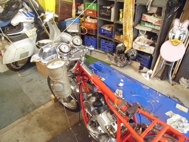

Well, yesterday I startet the motor for the first time with the configuracion mentioned above and the ignicion more or less. It runs
and seems to rise the revolucions very easily (there are some gr taken of the crank, primary, valve drive and clutch
- k-DSCI0067.JPG (76.34 KiB) Viewed 25154 times
I´ll try to finish the bike in may to do the maiden voyage in june towards the german mmeting in the black forrest via Madrid (the spanih meeting will be one weekend before). That will be a great adventure, some call it crazy

It will be interesting to see how you get on, I like the way you have tucked the pods out of the airstream, any chance of a close up of both carbs? I really like the Excalibur white faced clocks, I thought mine was the only one using them!

pedro wrote:It will be interesting to see how you get on, I like the way you have tucked the pods out of the airstream, any chance of a close up of both carbs? I really like the Excalibur white faced clocks, I thought mine was the only one using them!
It´s all very narrow on this bike
unless the driver
Yes, the clocks are the best and only from the Excalibur(except the motor)
Only that they already stop at 180 km/h
at least there is no stopper, so you cn turn it around
