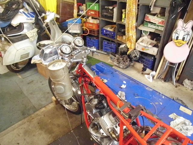

Hi Ian,
my configuracion is a bit out of the usual one:
pilot and starter 50, main jet 130-135, needle X18, atomizer 268T and 50 slide
Unusual is the slide 50 and the wider atomizer 268T. I guess it works because the more gasoline (because of the wider atomizer with the usual X18 needle) is equalized because of more air because of the slide 50. I don´t know but it works fine since about 70 000 km, consuming about 5 - 5,5 l/100km going a bit sportive. A 501 needs a bit more fuel than a 350 :wink: I can do about 200 km till opening the reserve. It´s runnig with an empty original filter box of the 350.
With my new project Dulcinea I will begin with the the same configuracion, perhaps with a bigger mainjet because of K+N filters. If everything goes as expected I´ll know about april/may if it works, then I let you know.
pedro

Posts: 935
Re: 501 with PHBH28 - needle valve size?
Well, yesterday I startet the motor for the first time with the configuracion mentioned above and the ignicion more or less. It runs :P and seems to rise the revolucions very easily (there are some gr taken of the crank, primary, valve drive and clutch :wink: )
I´ll try to finish the bike in may to do the maiden voyage in june towards the german mmeting in the black forrest via Madrid (the spanih meeting will be one weekend before). That will be a great adventure, some call it crazy :lol:
pedro

It will be interesting to see how you get on, I like the way you have tucked the pods out of the airstream, any chance of a close up of both carbs? I really like the Excalibur white faced clocks, I thought mine was the only one using them!
Posts: 935
pedro wrote:It will be interesting to see how you get on, I like the way you have tucked the pods out of the airstream, any chance of a close up of both carbs? I really like the Excalibur white faced clocks, I thought mine was the only one using them!
It´s all very narrow on this bike :roll: :P unless the driver :lol:
Yes, the clocks are the best and only from the Excalibur(except the motor) :lol: Only that they already stop at 180 km/h :roll: at least there is no stopper, so you cn turn it around :lol:
pedro

This looks a fabulous bike, more pictures please!
