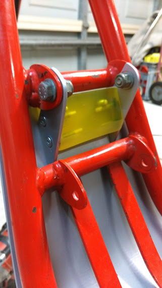

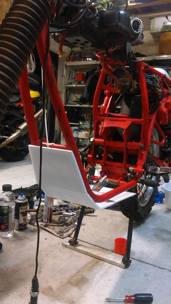

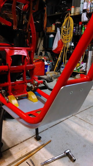

Getting bored waiting for the heads to be fixed. Thinking of making a bash plate. Here is a mockup.

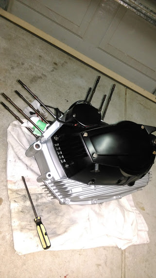

Finished painting the motor. Or what I have of it.

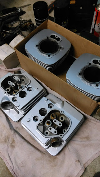

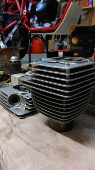

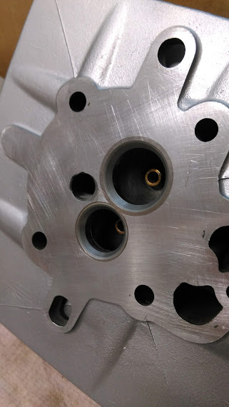

Been a while waiting for my heads and barrels to be done. Got them back and painted them. Still need to get the exhaust thread done. But he is busy till after chrissy. Been to hot for riding anyway. 40 c for days on end !
So here is some pics of the new valve seats. He siamesed the exhaust into the inlet just a bit. Bored barrels, honed, new guides, valves, rings, pistons, the lot.
Bike should outlast me now

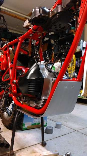

Made myself a bash plate while I wait for the head to come back from getting the exhaust thread repared. Came up ok I think
