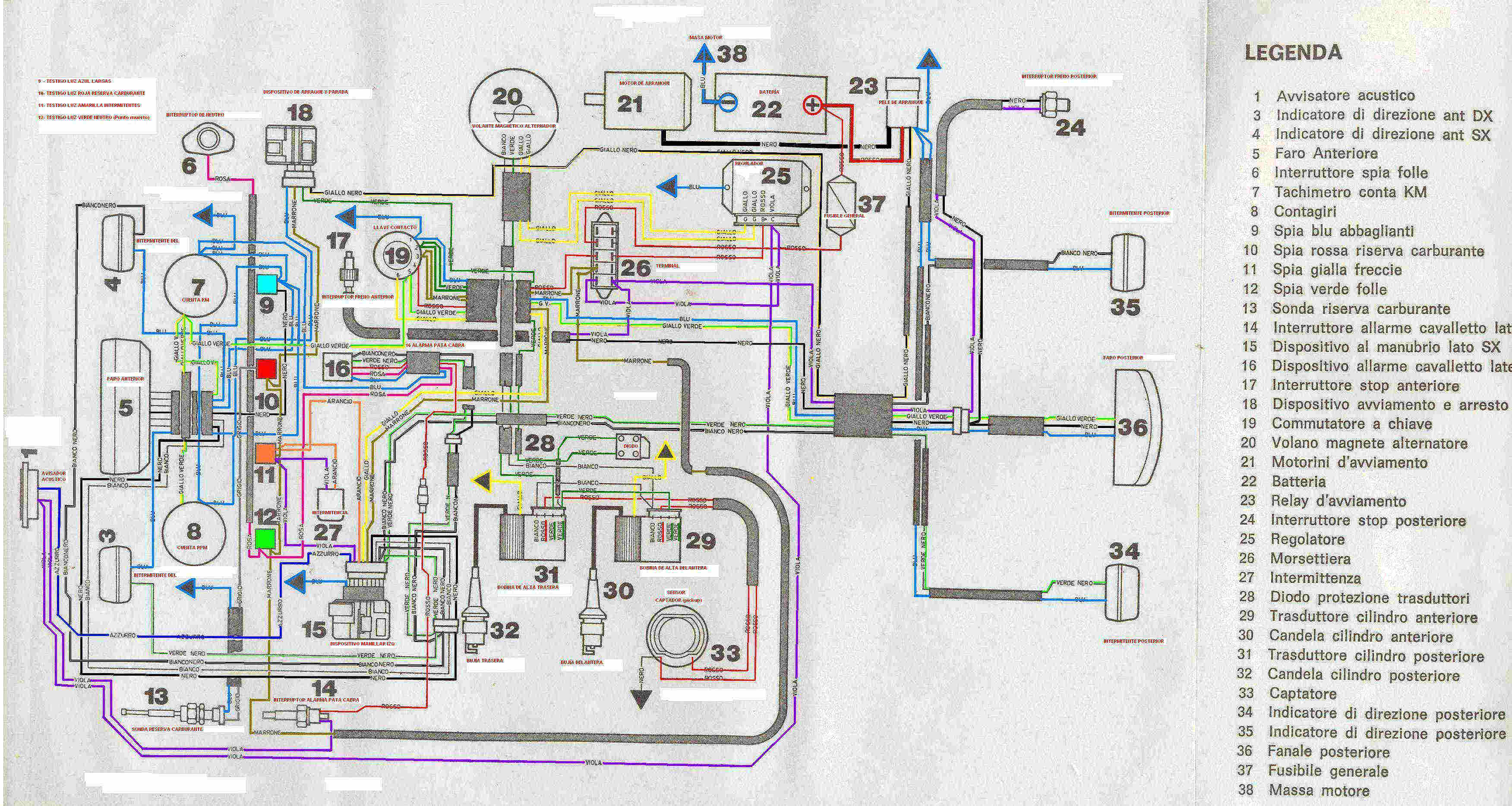

steveffs wrote:Hi I am rebuilding an X3 from a large pile of bits. I am currently stuck with the wiring. so before I start asking what wire goes where I thought I would ask if any one has a wiring diagram for the X3. Also is there a fuse box? all I have found is the Bakerlite junction box one inline fuse and one Diode connector.
Thanks for your help
Steve
Hi Steve,
I was looking for an X1 diagram for ages, but came across this colour copy for a 12v Kanguro -
It looks a match for the black and white copy posted earlier, I can't find a link from whence it came, so copied here as an image....
ESQUEMA_ELECTRICO_KANGURO_350_COLOR 12va.jpg (469.19 KiB) Viewed 12845 times
I hope that helps you out, and good luck with the repairs.
Cosmo

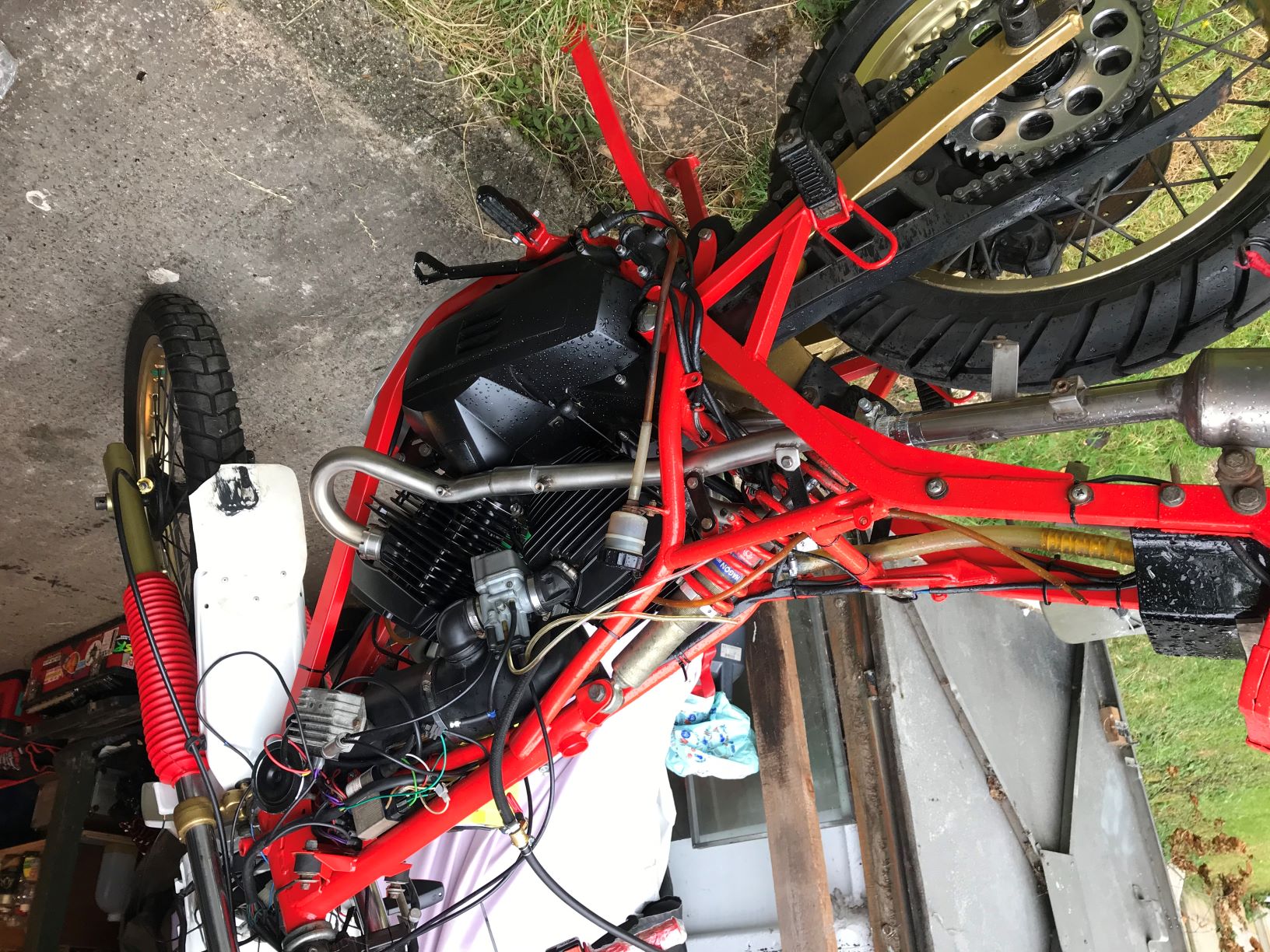

undressed but almost there
IT LIVES!!!!
Thanks for all the help. Finally got the bike up and running. No weird noises in fact rather pleased with the sound. Need to tune and balance the carbs and then hopefully will get the tank on in the next week or so for a ride up the alley!
Just a couple of hopefully simple questions.
Where does the horn locate?
how critical are the the rubber boots that go from the the throttle cables into the top of the carbs. Both of mine are a bit split?
Steve
