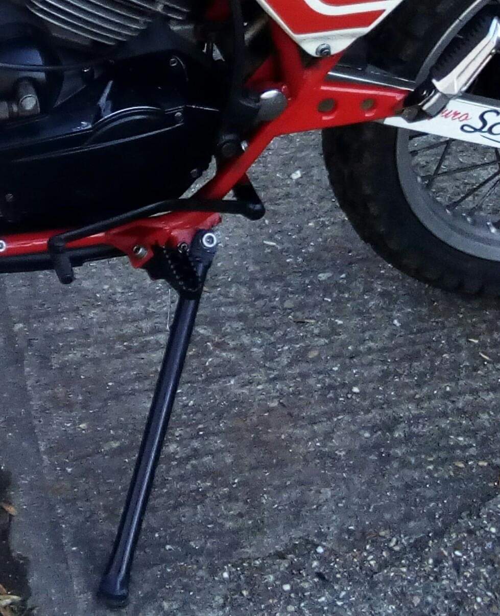

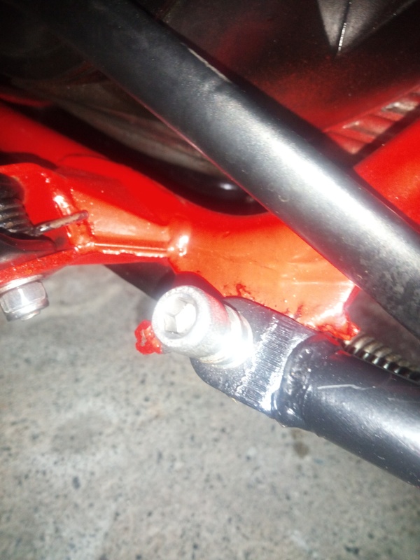

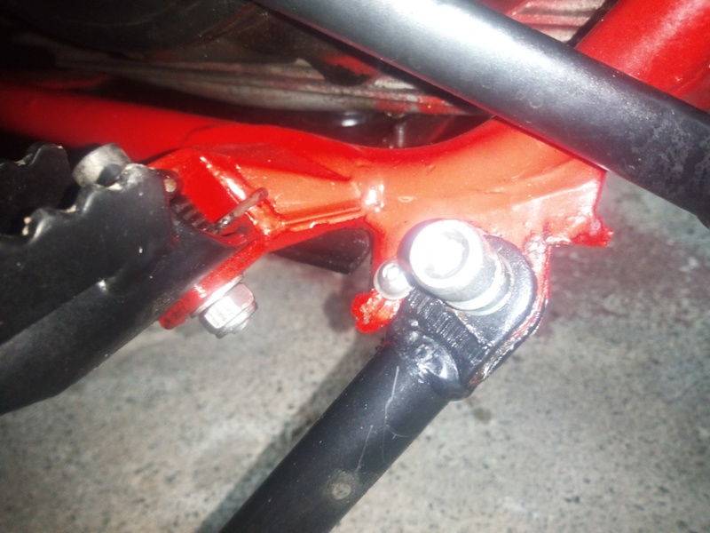

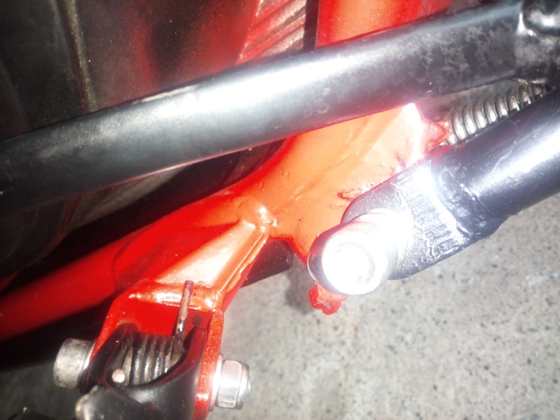

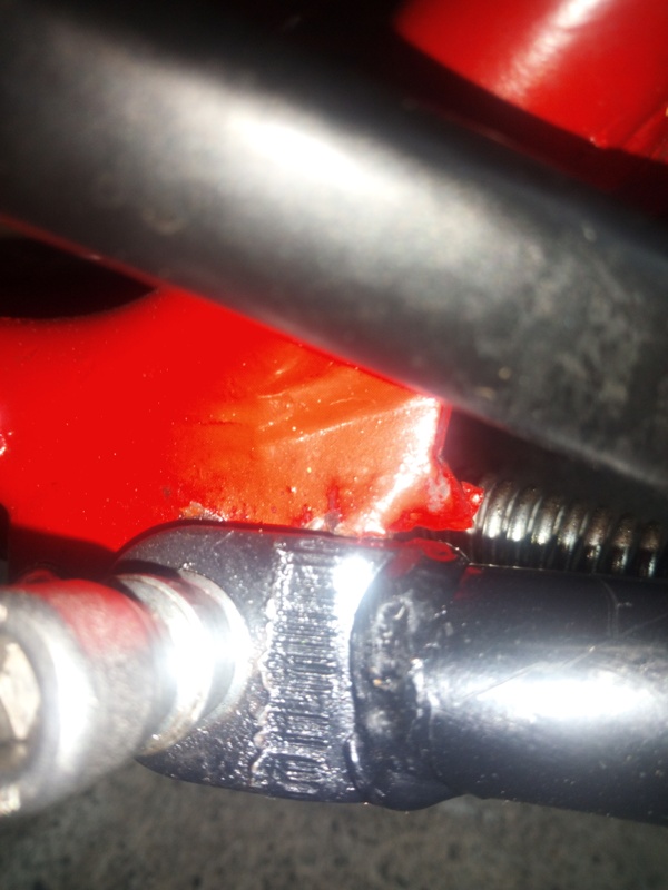

Yes will do, but mine had a factory lug on the frame behind the footpeg although the previous owner had welded on a bolt on generic one forward of that. I had to grind that superfluous lug away and make good.
No new parts were available from NLM/medina or anywhere, so I originally modified a pattern "pit bike" one from e-bay. You'll need a long one - 384/385mm and will need to use a different through bolt with a locknut on the back. It was cheap, fits well and the stand spring and retainer is in the right place and doesn't foul the swing arm, although it is rather lightweight and was easily bent. I used a bolt sleeve for spacing and a long SS allen bolt bolted through the mount and into the thread in the stand AND with a locknut on the back. Search "pit bike stand 384 or 385mm" It does the job for now, but I bent mk1 and had to replace it with same.
I have now welded up a permanent stouter version using the bolt lug cut from the bent Chinese one. Same length, but made out of 3mm + thick tube. I drilled through the tube at the spring retainer pin position and welded a long M4 bolt in there. Once ground off flush and roundheaded it looks factory. A sturdy footplate thick washer was welded on the bottom at an angle to suit. After powder coating it's spot on but I haven't got photos of it I'm afraid as I'm grounded and the bike's not here.
Pics of version 1 here if they help.
Ok

Here's a couple more photos of the frame mounted stand.
