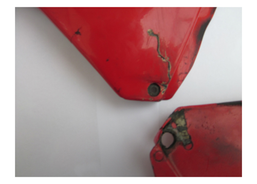

The body panels are all damaged in some way except for one of the black front grill things that seem not to be necessary.

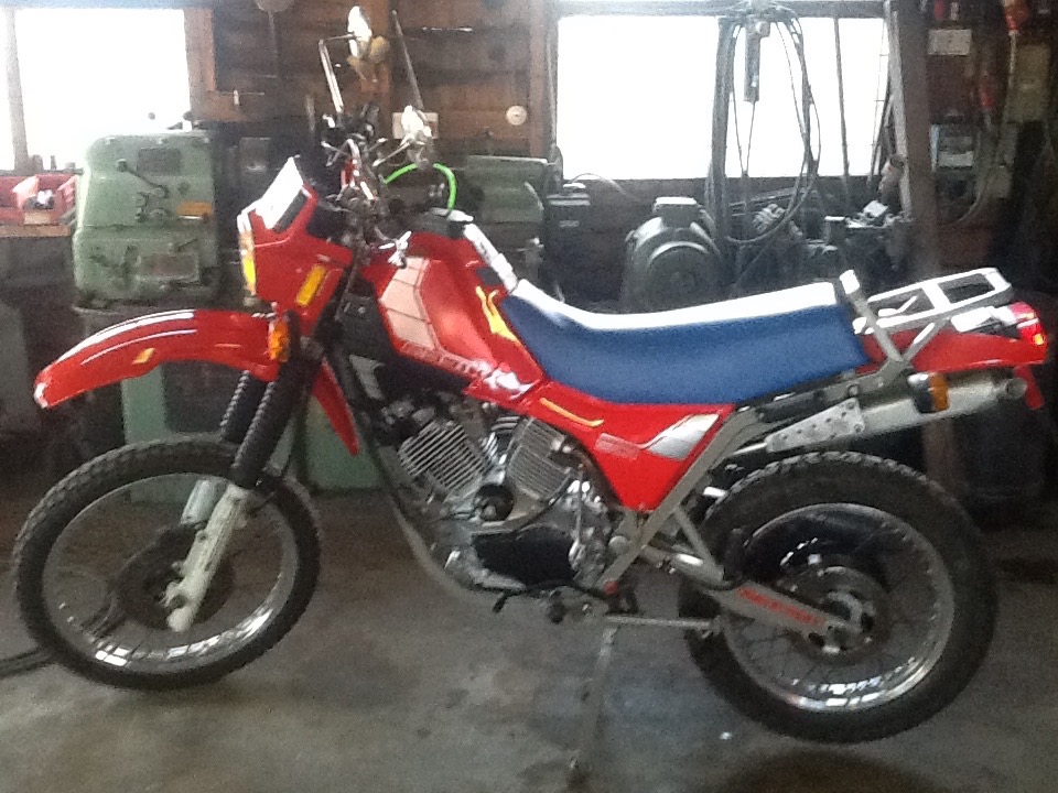

Well the dear old 501 has a new home.
I only rode it once, up over Hartside. It went well enough but was too tall for me.
Anyway it was my first real renovation and I learnt a lot.
Goodbye dear friend.
