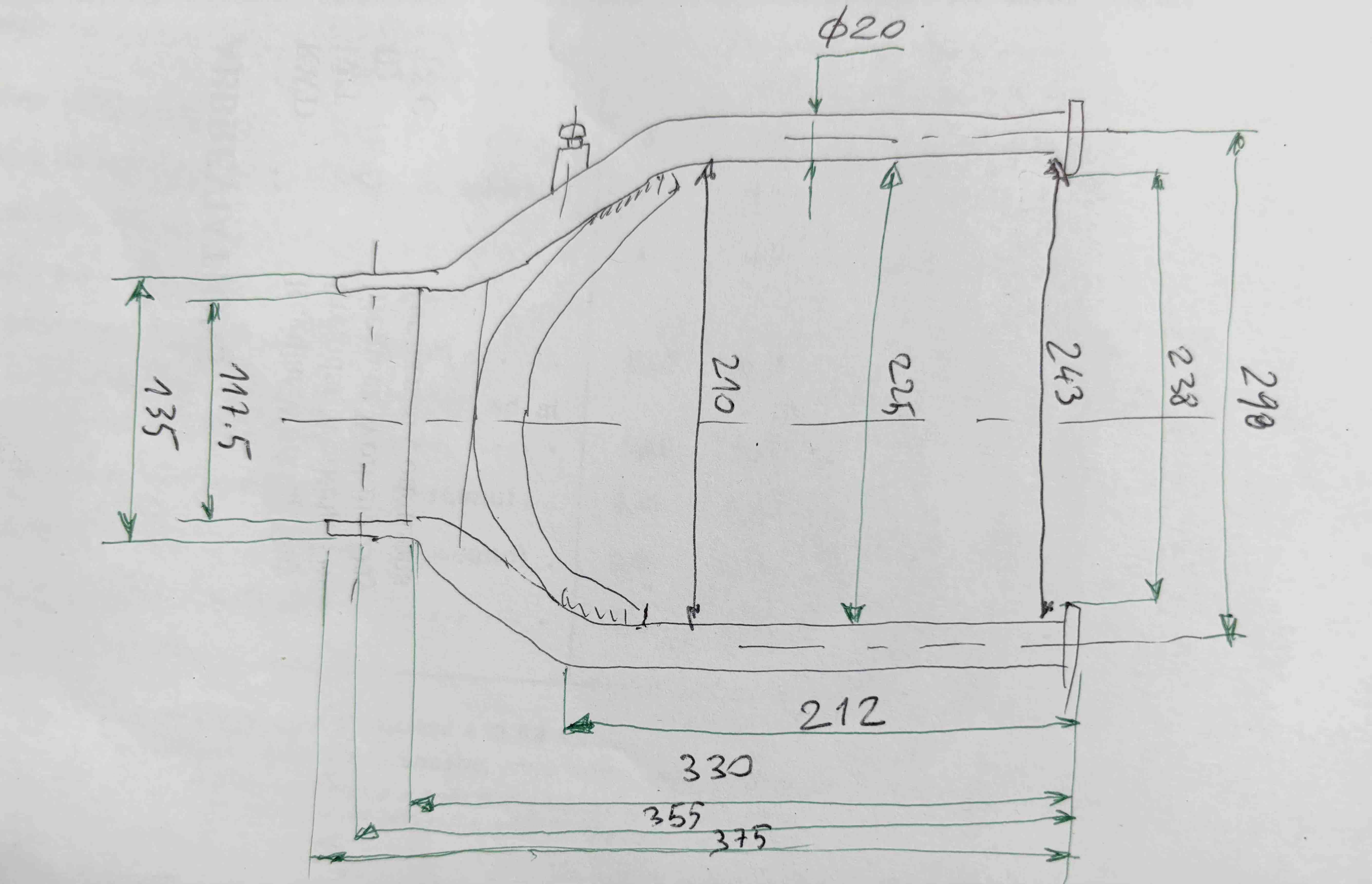

Members: I am looking for a center stand that fits a Camel500 from 1981thru 1983. I know they are rare as hens teeth. Any help would be appreciated.

Sorry, but as you've found they are almost impossible to find. It seems the only way is to copy someone else's bike to get one made. The original is quite simple and lightweight construction. If you can do, or get done welding cutting and bending of steel it should be easy enough. I've just remembered there was a fellow in Italy who made batches of them. I think a bit stronger too, but sadly I can't remember the name!

Angelo: Thank you for responding with the photo. If you can post me measurements of the stand. I would need total length of the legs, width of mounting bracket, length of leg from bottom of foot pad up to bend. Also size of center-stand bolt including length. Sorry for all the questions.

Drawing of stand in your mail. Bye Angelo

Hi, can the drawing be shared as someone is the UK is looking into getting a replica/s made to suit the Mk1 Camel?

OK. This is the drawing.

Great, many thanks for taking the time to do the drawing and sharing it
