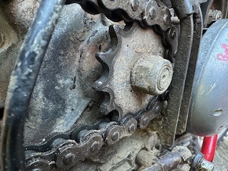

1) The sprocket seems to be on the wrong way round. Or is that normal for kanguros? Normally it’s offset inboard on the road bikes.

My BP7ES plugs are also very sooty so I'm keen to learn what others have found work well in terms of spark plugs. And I seem to recall that my front sprocket is as per the road bikes so the other way around from your photo. I am currently running 530 chain and sprockets for historical reasons, your front sprocket looks more like a 520 which should work at least as well and also allows for an O or X ring chain unlike my bike which uses a plain good quality DID heavy duty chain.

1- I think the sprocket should be as the road bikes. Probably reversed.
