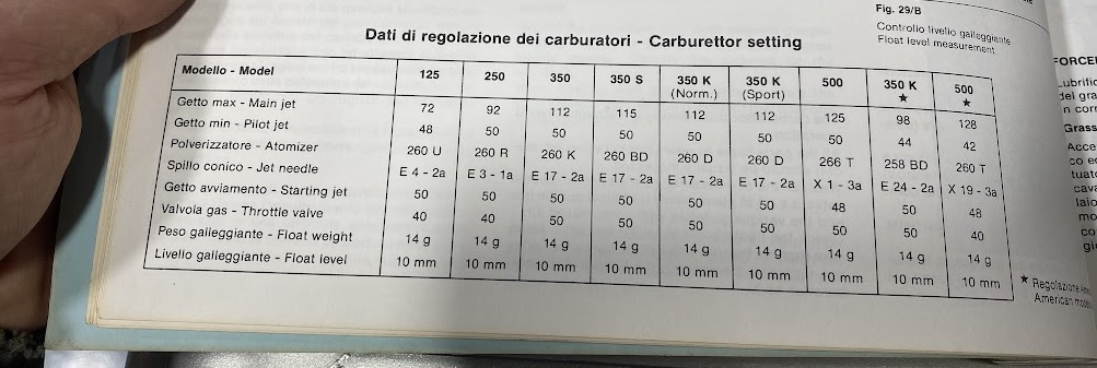

check out this page for the carb values for the settings: https://www.motomoriniclub.nl/carb.html
- Carburettor settings Camel 501.jpg (30.37 KiB) Viewed 12529 times

Thanks. Looking at that, it looks like I may end up being best off taking the bits out of the PHBH30s on there now to put into the 28s, and that may get me the closest. These 28s I have that came off of a Moto Guzzi have 58 idle jets, 76 choke jets, and 110 mains. The needles are X10s. Then again, maybe that extra fuel would be liked by the carb. When my rebuild kits come I'll probably pull the carbs off the bike and then mix and match the parts to get the closest that I can. I also didn't check the jet numbers etc. when I rebuilt the 30s that the bike came with.hendre wrote: ↑20 Apr 2022 07:57 check out this page for the carb values for the settings: https://www.motomoriniclub.nl/carb.html
