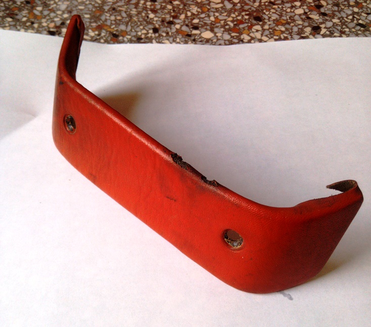

you mean this one?
I have two, one from a X2 and a X3. Both have cracked but you can use them to make a replica from stainless sheet material so at least they won't break when your motorcycle gear grabs hold of one of the corners :mrgreen:

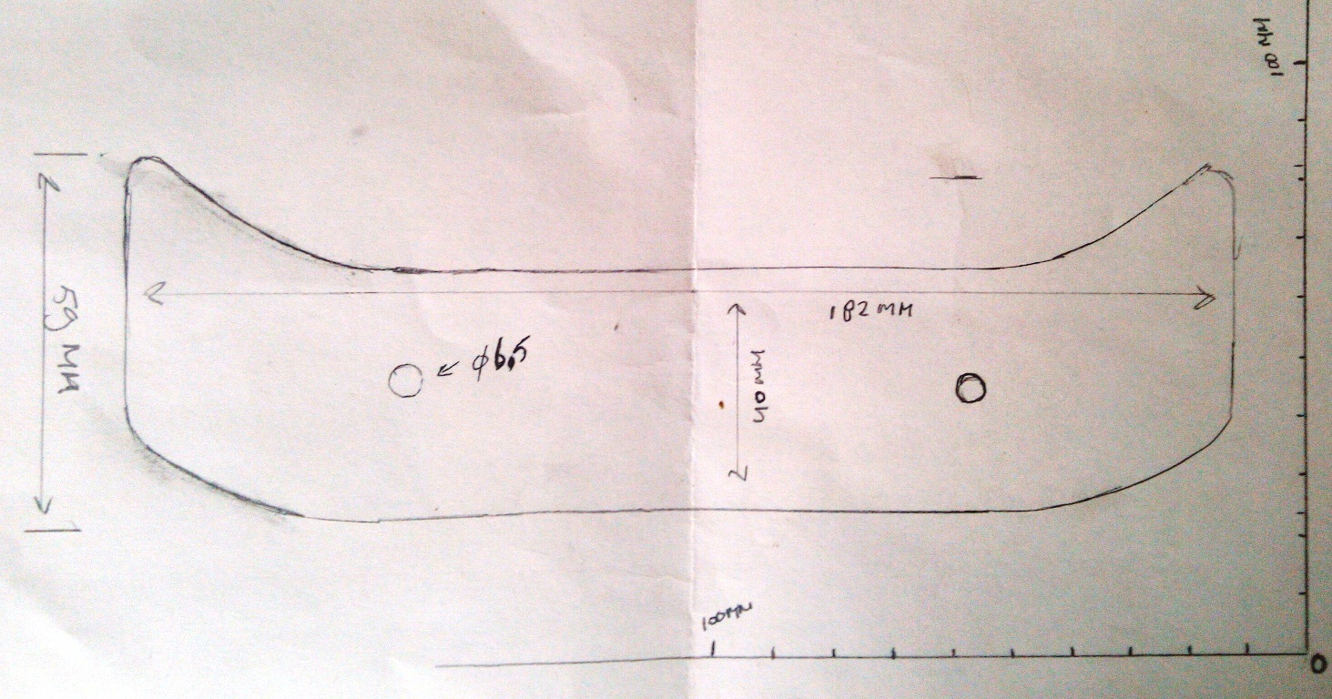

hendre
Posts: 600
Joined: 11 Aug 2007 06:51
Location: The Netherlands
Re: Tank Pad Kanguro X3
Post by hendre »
is this enough info?
drawing was a pain, when I removed the fabric the whole thing fell apart... 80-ies plastic is not very durable :wink:
when in doublt about the shape use the right side of the piture and mirror half of it (across the fold) to the left... right side is most accurate
acemorini
Posts: 333
Joined: 11 Sep 2012 13:49
Location: buxted east sussex
Post by acemorini »
Thank you Hendre,
very helpful.
Regards Pete.
