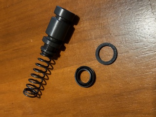

My front break master cylinder on my 1982 500 sport is leaking like Crazy and needs new o-rings. Any help on where on line I might be able to find them?

There are various diameters of the master cylinder and it'll be worth measuring yours in mm before ordering anything.

3potjohn wrote: 14 Sep 2025 10:22 Try https://www.mdinaitalia.co.uk/
Thank you so much This Site is amazing!!!! Exactly what I was looking for!
