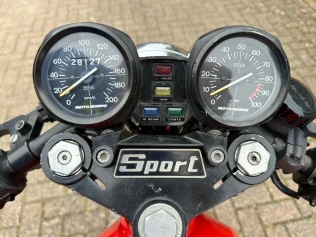

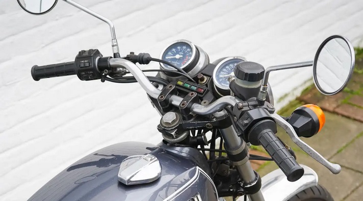

Re: Fork top bolt question...........
Actually, looking at the photos of Tims bike in the auction, the fork top nuts aren't the same as the ones that have a small countersunk screw in the top.
(The photo of the K1 Sport top yoke is of Tom's bike when it was up for sale)
- 2025-03-23 at 17-24-30 .jpg (85.72 KiB) Viewed 6285 times
- 1982 K1 Sport top yoke .jpg (107.36 KiB) Viewed 6285 times
- Posts: 1685
The top pic is of the type as in the older forks. The hex socket in the top had a countersunk screw that was a slotted type originally. I suspect his were replaced at some point with 'something close', like BA fitters used to do with windscreens replacements till they had that nasty incident at umpteen thousand feet. The original screws spring loaded a ball bearing on a seat, as a check valve.

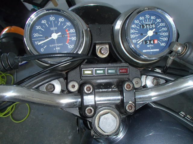

Ah that was silly of me - I should have taken a photo. I'll take one in the morning - when you look at the top of the fork there is a sunken bolt that initially looks like an allen bolt but it's actually a wavy/torx style bolt and there is a countersunk screw at the base of it as well. It doesn't look like a replacement if you know what i mean it looks like it's been in there forever. It looks like it's ally as well not steel hence my keenness to get a really well fitting socket to get it out!Morini Jen wrote: ↑23 Mar 2025 17:43 Actually, looking at the photos of Tims bike in the auction, the fork top nuts aren't the same as the ones that have a small countersunk screw in the top.
Here's a picture!TimClarke wrote: ↑23 Mar 2025 20:05Cheers, yes they look like torx but maybe a bit "wavier" but that ma be because they have been roughed up a bit in the past!Morini Jen wrote: ↑23 Mar 2025 15:47 Hi Tim.
Sounds to me that they need a Torx bit or screwdriver. They are widely available.. Screwfix, Halfords, Machine Mart etc..
Looks like a standard M12 hex bit to me. <shrug> It sometimes helps to loosen the top pinch bolts before attempting to remove the top plug.
The top caps in the picture would originally had a (slightly tapered!) hex which took a 12mm hex key. The taper on the hex is so the cap would come out of the casting die.
As for the small M6 c'sk screw in the centre, as has been mentioned, there should be a small spring and ball bearing under it so acts as a 1 way valve.
They just look like worn hex to me, rattle gunned maybe? Or imperial/worn keys used?
Mdina may have new or used items available as these forks were used on other Italians Ducati especially. If new are available I'd get some and use informed bodging techniques to get the old ones out. As Charlie says too, slacken the top yoke pinch bolts first.
And if you go for replacements, make sure you specify the thread pitch you need! Both 1mm and 1.5mm pitches were used.
If Mdina have no stock, classic ducati might well have.
See: https://www.classicducati.com/products ... ork-plugs
