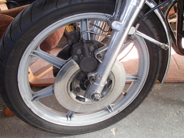

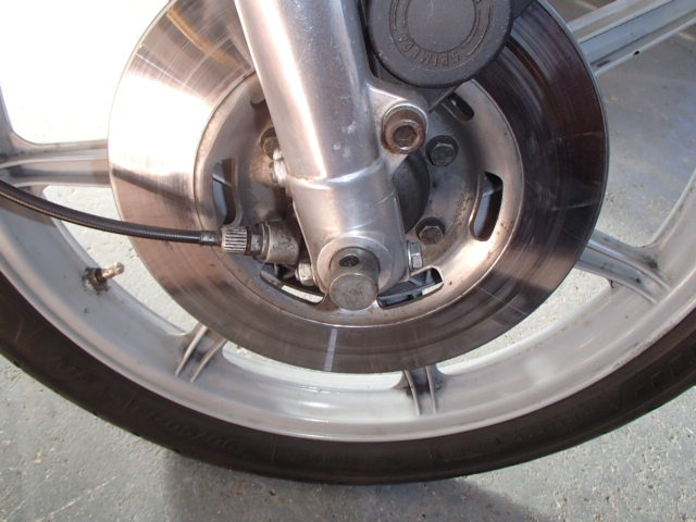

Update on brakes - the rear disc is sorted, it looks like it could do with a skim but it works as well as i want a rear brake to work and there's no binding any more.
Front discs do need sorting though in that they seem reasonably powerful and smooth about about 30 but between 30 and 5 pulsing gets progressively worse accompanied by some mildish brake judder which i don't like.
Any ideas worth trying or is it time to grind off the chrome, which is patchy on the insides of the discs?
Galligaskins
Posts: 41
Joined: 01 Oct 2024 19:28
Location: Loughborough, UK
Re: Brake discs
Post by Galligaskins »

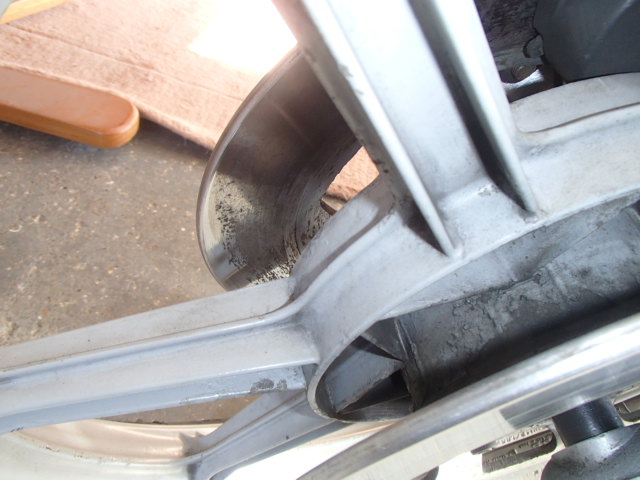

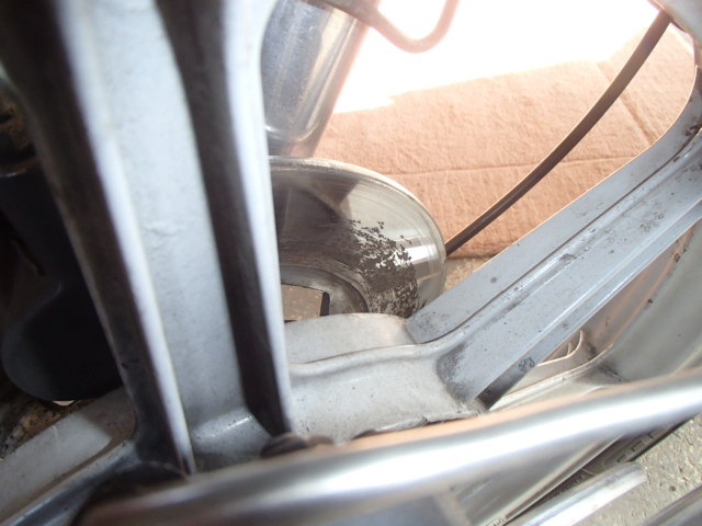

I had a similar issue on the bike I bought last year. There was a dark print of the brake pad on the inside face of the disc and a consequent pulsing of the brake at low speed. Particularly annoying when trying to come to a smooth halt.
Colour me nasty but I introduced the brake disc to my random orbital sander with some 60 grit. The chrome on the disc is incredibly hard so no concerns about taking too much material off, but with a bit of effort I managed to remove the imprint making sure to address the whole surface to keep it consistent.
That's fixed it. Initially, the braking power wasn't as good as previous but as the disc surface polished up again and bedded in over just a few miles it's back to the same power as before minus the judder.

They don't look to bad on the outside, but the insides are very patchy
