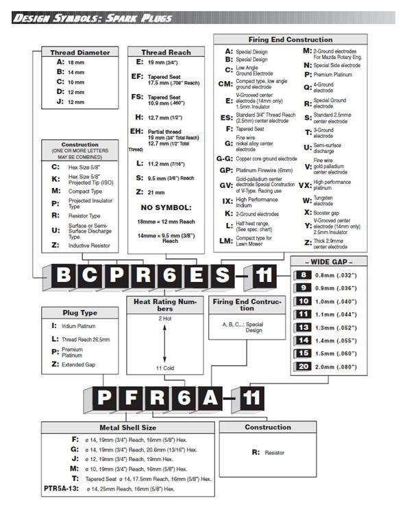

I just bought this bike and it seems nice but has sat around for a while so i did anticipate it might be hard to start at first. Spins over quick but not firing and the first thing I checked were the plugs. It has B7ESs fitted - so my first question please - is that OK instead of BP7ESs?

http://www.brommer-forum.nl/faq/200/1.jpg
"P" has to do with the insulatortype, projected or not.
but it doesn't ring a bell what the actual difference might be, I always use the BP-series when buying NGK
but they costs next to nothing so changing won't break the bank. Do not buy from internet, lot of fakes around.
just buy from the local garage.
kind regards Anne

Plugs should be projected nose plugs- BP
Regarding heat range, you may find the 8 a bit cold.
I’d probably start with BP7ES and see how they fare.
Thank you - I managed to find the BP7ES plugs and will fit later today!
