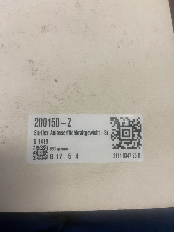

Posted: 03 Oct 2023 18:04
by Canuck750
The replacement Sureflex starter clutch arrived last week from Stein Dinse, looks like it is what I need.
Thanks for directing me to these parts!

Posted: 04 Oct 2023 17:38
by 3potjohn
Those are much more effective than the earlier type, as you should discover.
