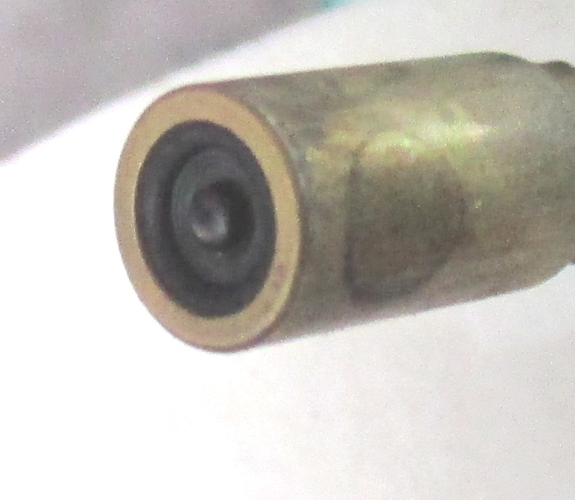

Im wondering if the floats are at the wrong height. Something I didnt check. If they are too high it can richen the main jet up.
The chokes are sitting fully down when off but I didnt replace the rubber insets in the bottom of the choke plunger and they did have a slight circular ridge in them.

the float height is 24mm which appears to be spot on. Everything looks good except the choke rubber. I will order some replacements and see if that stops the rich idle.
- choke rubber.jpg (295.01 KiB) Viewed 11372 times
Re: carburation issues.
And have a look at the little mixture screws. Especially the fron one may have lost the peak. There schould be the srew with its peak, the spring, a little washer and at least a small O-ring. the washer is to protect the O-ring towards the spring.
