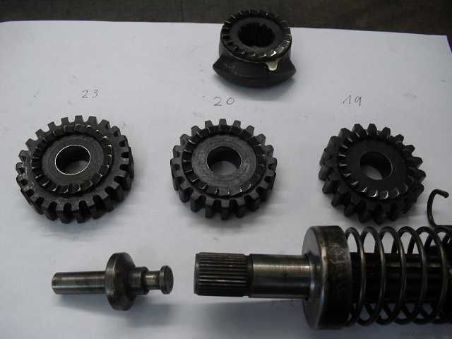

Re: Anyone with a 501/507 engine in bits on here?!
23 teeth: 500 5 gear and 250T
20 teeth: 350
19 teeth: 500/501 6 gear, only this one has "sharpened" teeth
The rest of the kickstart mecanism is the same
20 teeth: 350
Incredibly useful Norbert, thank you and thanks for taking the trouble to take pictures!!!
