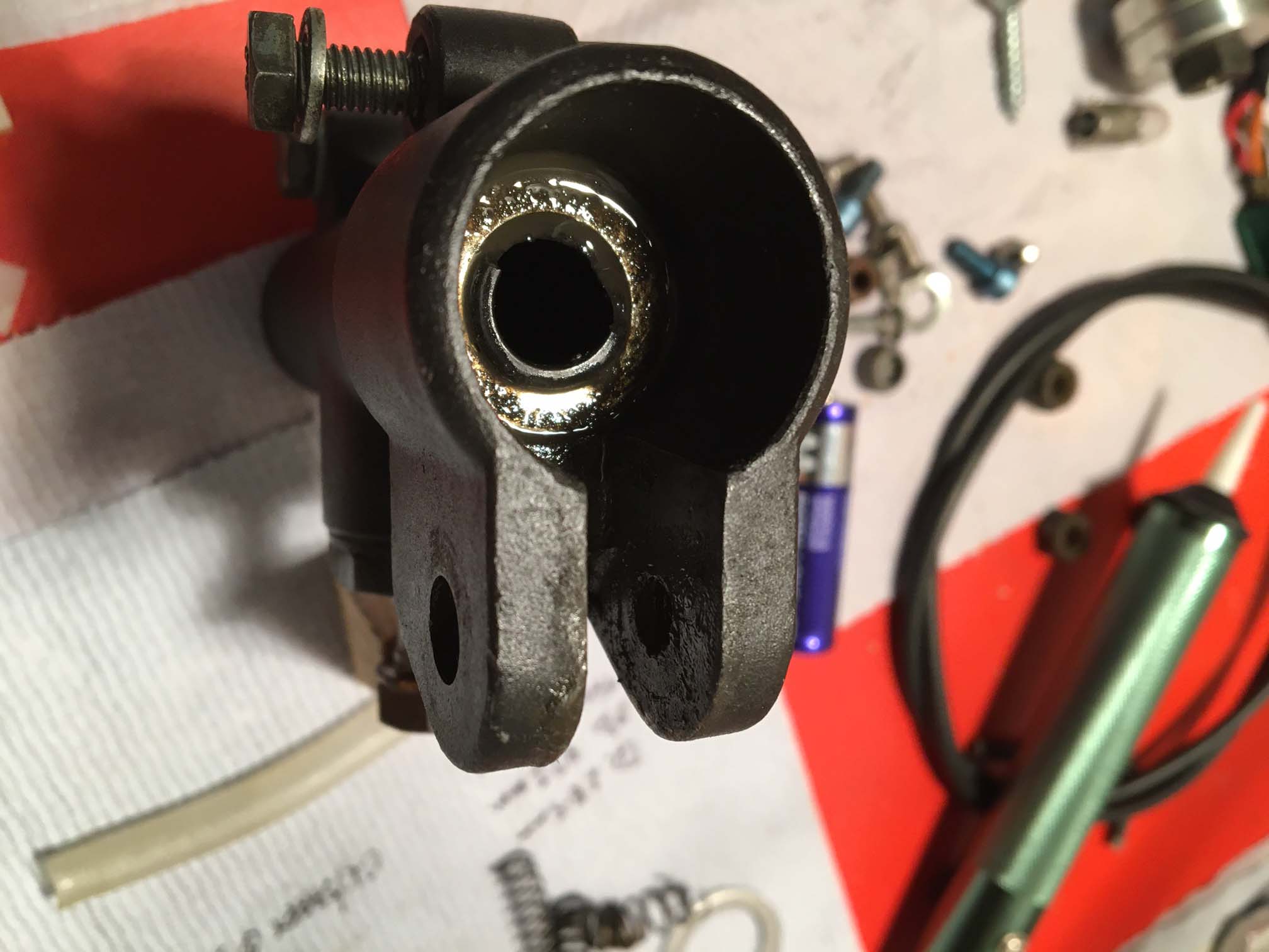

Morini rear master cylinder_IMG_2220.jpg (182.04 KiB) Viewed 13165 times
Grimeca rear master cylinder for 500 Morini

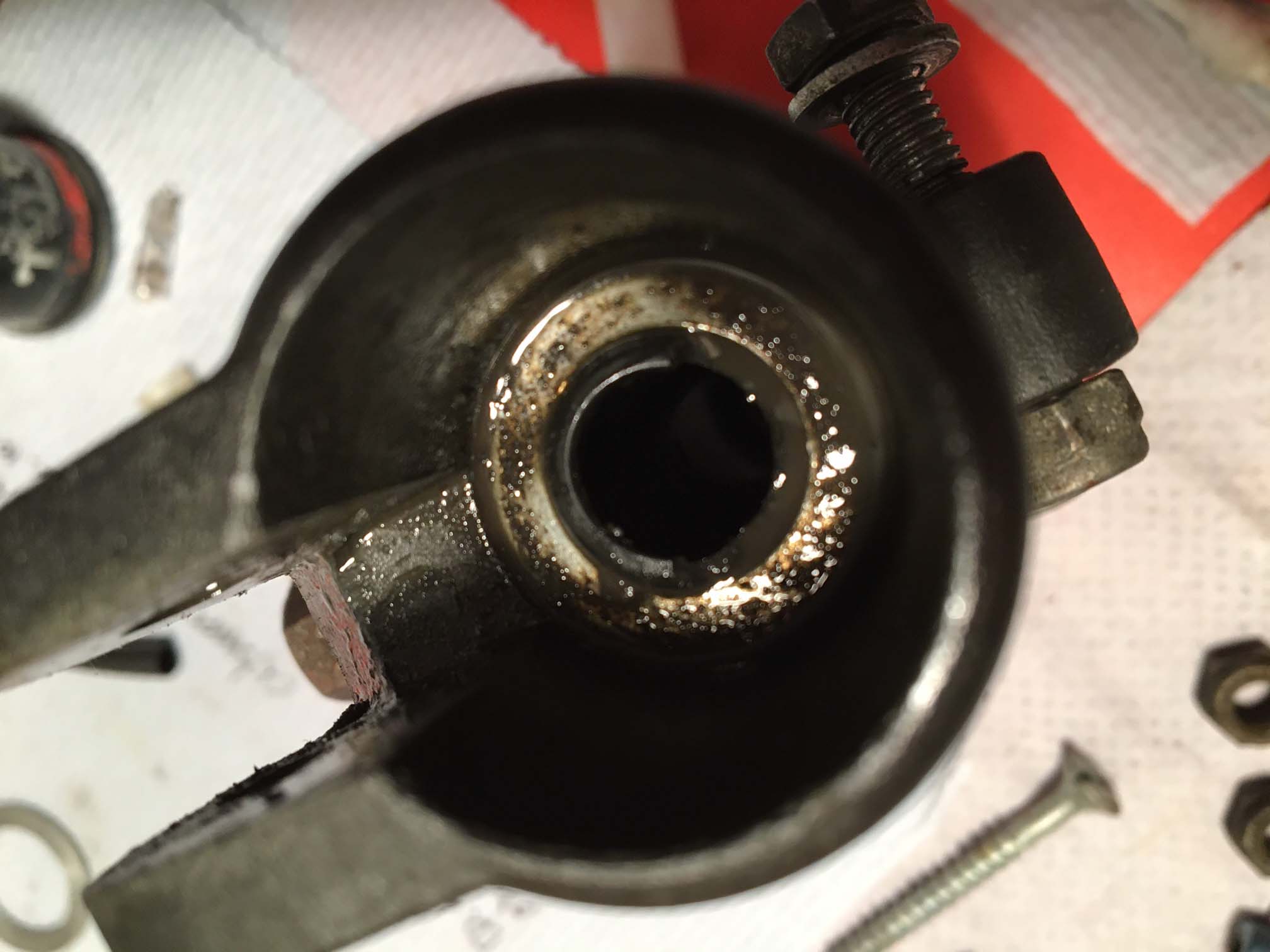

Morini rear master cylinder_IMG_2219.jpg (161.4 KiB) Viewed 13165 times
I am in the process of renewing the seals, boots etc on my 1984 Morini 500 Sport and would appreciate some advice.
1. In the mouth of the mastercylinder there appears to be a dust seal/boot at the entry to the main bore that is perhaps retained or just sited behind a "washer" - see photos. How do I remove this so that I can replace the seal/boot that seems to be torn and which I suspect will make the insertion of the piston subassy difficult?
2. In order to remove the caliper pistons and their seals, is it best to split the calipers into their respective halves? If so, are there 2 'O' rings that seal the 2 halves? Is there a torque setting for the 2 cap head screws when reassembling the halves?
3. I realise that I should probably have pushed the pistons out with the mastercylinder still connected to the caliper - does anyone have a good method for extracting them by other means?
4. Finally, where is the best place to buy these parts from - Mdina seem to have a very limited set of items on their website. I would have thought that it would be possible to buy a refub kit for both the mastercylinder and the caliper with all seals, boots, 'O' rings, copper washers and springs. Am I living in a dreamworld or have I just not found the right site?
Thanks,
Charles

i did rebuild the calipers on my morini using plain o-rings ,
you need EPDM o-rings for use with brake fluid.
i did not have to rebuild the master cylinder , cant help you there.

Thanks for the info. I have bought some seals + O ring from Mdina Italia. They are similar but not identical so am wondering whether the old seals were incorrect - could they have been Brembo parts?
As for the dust seals, well those that I bought are significantly different to those that I took off so I am a bit confused.
Adios,
Charles
