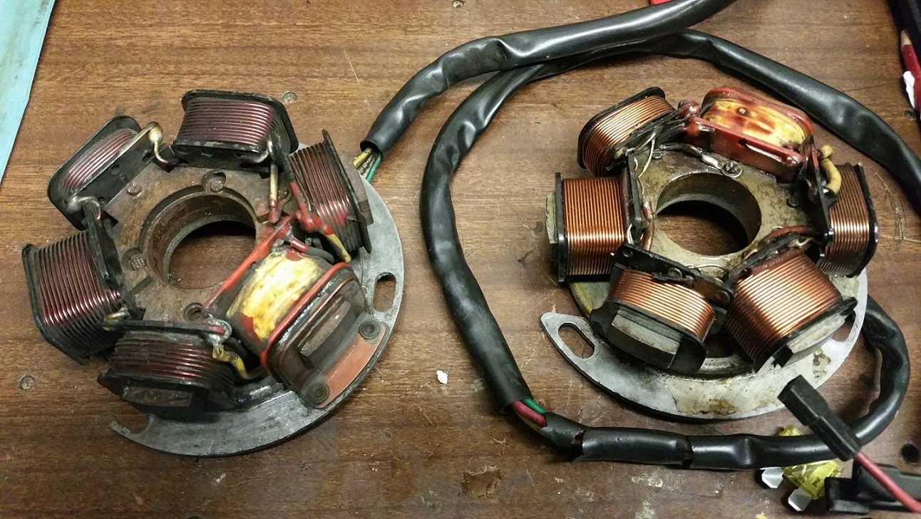

And I take it the stator on the 500 is different from the 350?
mbmm350s
Posts: 713
Joined: 22 Jun 2018 10:18
Location: Reading UK
Location: Berkshire UK
Re: Cutting out under load
Post by mbmm350s »
The 500 stator (for the 500W roadbike model) is the one on the left, the early 350 (sport/strada) on the right.
The 500 stator has 4 wires, Yellow,yellow (which are the lighting circuit) green (for the CDI ) white (earth)
The original 350 stators as in picture have an additional red wire in the lighting circuit, and no white wire. 500 off road bikes stators are different again.
Stators
Stators
If you measure the resistance of the green winding to earth when it is disconnected and it measures under 220 ohms you should consider rewind, if under 180 ohms the rewind is a must. Initial specification is 300 ohms (but often the rewinds are a little under this at 270-280 ohms)
Rex's speedshop can re wind
