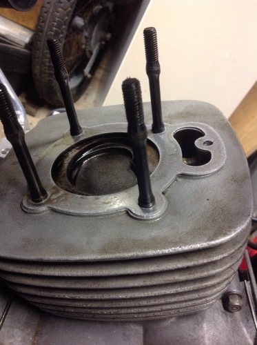

Further to this, I have taken both heads off. The front all looked normal so cleaned up and put new head gasket on and head ready for torquing?
The rear however looked decidedly poorly, a puddle of oil in the combustion chamber. So I lifted the cylinder to have an look, there was a lot of oil around the pushrod tunnel, camshaft area that looked pretty dirty. How does the oil drain from this area could there be a partial blockage? Some how causing a build up, up to the head gasket?
The top two piston rings were within tolerance but the bottom oil control ring? Has a ring gap of at least 2 millimetres is this normal. Ps the piston and bore all looked good the piston especially with no signs of blow by etc.
I seem to recall does the rear pot get more oil splash due to the rotation of the crank?
The bike has done 31k and usually goes rather well but I have no history when purchased other than it was owned by a Mr M Challis from Chelmsford about twenty years ago.
Re: While my cylinder heads gently weep!
The picture hopefully shows the oil build up after only ton miles running
Just blew the head gasket straight away
Any ideas! Off to hunt out a valve Spring compressor

For the oil draining question, with the barrel off you should see a couple of hole of about 3/4mm dia between the cam followers/tappets. Haven't seen them blocked before but suppose it could be done with gasket goo etc? If oil did build up there I suppose it could easily pressurize as the breather in the rocker cover is quite small and that upper chamber will get smaller as the oil builds up. Obviously you have checked the joint faces and the four cylinder studs were pulled down evenly as well as the 6mm screw on the pushrod tunnel? Not much else to go wrong!
Ok Steve thanks for that, I’ll have a look in the morning. when I had the cylinder off before there was certainly plenty of oil around that area.
Lifted the rear pot and the holes near to the tappet/ pushrod are clear.
So going to investigate the breather box.
Tried annealing an old base gasket yesterday, put permanent marker on it then heated on the burner until the marker burnt off allow to cool. Created a lovely pliable gasket, compared to the new ones from nlm that are hard etc. I guess every one uses these though.
Please what is the best torque sequence and values as there seems to be a few out there. 2.7 mkg then back off and re do to 2.2 mkg or Harglo manual 2.5 mkg.

Further to this my bike is back together now and touch wood no leaks, I used the annealed gaskets and torqued to 2.5 m/kg
Also cleaned out the breather box that was quite full of (stuff). After a carb tune the motor now starts and runs far better.

All the later engines I've seen had been assembled using a gasket and sealant by the factory. The stuff they used seems a lot like 3 bond aka Yamabond, so that's what I use and it serves me well. This is on all joints including the cylinder head.
It looks like I misunderstood where you are getting the oil build up, I thought in the pushrod tunnel but it looks like you meant the cylinder itself? The head joint would have to be very obviously bad or damaged for it to get from the pushrod tunnel into the cylinder, and the only other ways are up from the crankcase past or round the rings, and through the inlet valve guide. Or cracks from the rocker area into the combustion chamber?
