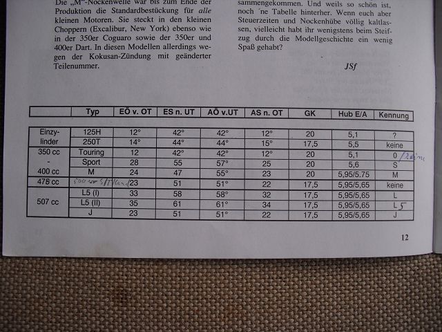

Re: 501 Cougauro
This ware the dates I have collected:
Camshafts
Cam Inlet Inlet Exhaust Exhaust Lift Base I/D
opens closes opens closes (I/E) circle
125H 12 42 42 12 5.10mm 20mm ?
250T 14 44 44 15 5.50mm 17.5mm none
250J(twin) 12 42 42 12 5.10mm 20mm O
350GT 12 42 42 12 5.10mm 20mm O
350S 28 55 57 25 5.60mm 20mm S
Dart(400)? 24 47 55 23 5.95mm/5.75mm 20mm M
478 23 51 51 22 5.95mm/5.65mm 17.5mm none
L5(I) 33 58 58 32 5.95mm/5.65mm 17.5mm L
L5(II) 35 61 61 34 5.95mm/5.65mm 17.5mm L
J 23 51 51 22 5.95mm/5.65mm 17.5mm J
2+2 56 75 78 52 6.50mm/5.65mm? 17.5mm 2+2
X-1 54 75 78 55
'M' cam fitted to Coguaro, 350K, Excalibur, both Darts
'J' cam fitted to 501 Excalibur
'X-1' Mystery cam listed on sheet in Italian passed to me by Herdan.
(this dates come from Holland or england) I think that the M was not mounted in the K-model but surely in the K2
this one has been published in "La Strega"
