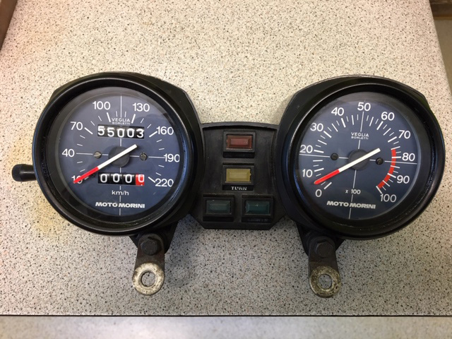

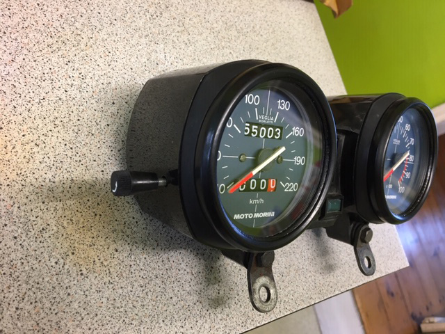

A quick update. I sent the clocks to Peter Bond (aka the gaugeman) and after 4 weeks, as per quote, they arrived back home looking like new. Peter Bond, has basically serviced the clocks, adjusted the damping etc so that pointer (needles) do not jump about, fitted new bezel, refurbed the faces and the pointers (or they may even be new), fitted some new internals and all looks good - see attached photos.
Not cheap but I think that the quality of his work is good.

- Sideview to show the new trip reset made by Peter Bond - he needed the mounting pod to ensure the diameter of the reset know were correct.
- Refurbished clocks_new speedo trip reset_IMG_2286.jpg (175.08 KiB) Viewed 13781 times
- As you see them when sat on the bike
- Refurbished clocks_IMG_2285.jpg (188.14 KiB) Viewed 13781 times
