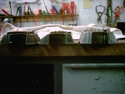

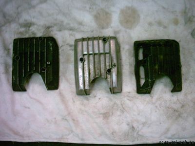

Re: Smoking Engine - Any thoughts?
Her you have the three types of rocker boxes
on the left the old ones, in the middel thee usual ones and on the right 501 now on the left first series, in the middle 501, on the right the normal ones norbert
