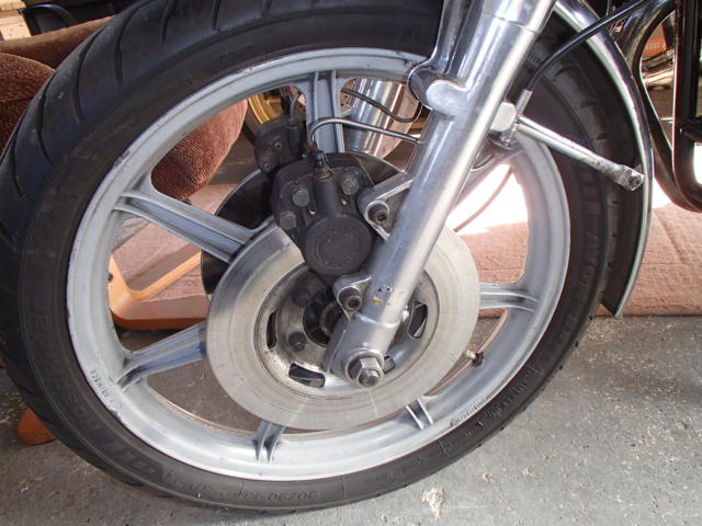

I wonder if I just stick a couple of hundred miles on the bike the braking process will take off the rust/patchiness?TimClarke wrote: ↑04 Apr 2025 10:06That's really interesting - i'll have a good lookGalligaskins wrote: ↑04 Apr 2025 09:13 I had a similar issue on the bike I bought last year. There was a dark print of the brake pad on the inside face of the disc and a consequent pulsing of the brake at low speed. Particularly annoying when trying to come to a smooth halt.
Colour me nasty but I introduced the brake disc to my random orbital sander with some 60 grit. The chrome on the disc is incredibly hard so no concerns about taking too much material off, but with a bit of effort I managed to remove the imprint making sure to address the whole surface to keep it consistent.
That's fixed it. Initially, the braking power wasn't as good as previous but as the disc surface polished up again and bedded in over just a few miles it's back to the same power as before minus the judder.

Ah. Have to say yours looks a lot worse than mine did
I'm not sure that looks recoverable at home. I don't think normal brake usage will rectify that. I did a few hundred miles on mine with nothing like the level of rust/patchiness and it didn't improve, hence resorting to the orbital sander as I reasoned I had nothing to lose. I hope you can get your discs sorted somehow. Maybe The Disc Doctor as others have said. I've no experience with them.

Re: Brake discs - FRUSTRATING!
Well.
The only thing I really didn't like about the bike was the brakes.
Unpleasant pulsing on the front and gabbing/overheating on the back.
I thought it odd that an expensive renovation hadn't addressed either.
The rear disc was absolutely shot with deep grooves and the pads were in a shocking state. New pads and a skimmed disc have improved things very much cosmetically but it's not as powerful as it should be - I am wondering that they've taken so much metal off to get rid of the scroring the disc isn't thick enough now? It measures 5mm?
Front discs skimmed down to 6.3mm and they look great and the calipers are rebuilt too. BUT, having gone for a spin around the block the pulsing is EXACTLY the same as it was before so I'm at loss really. Any ideas?

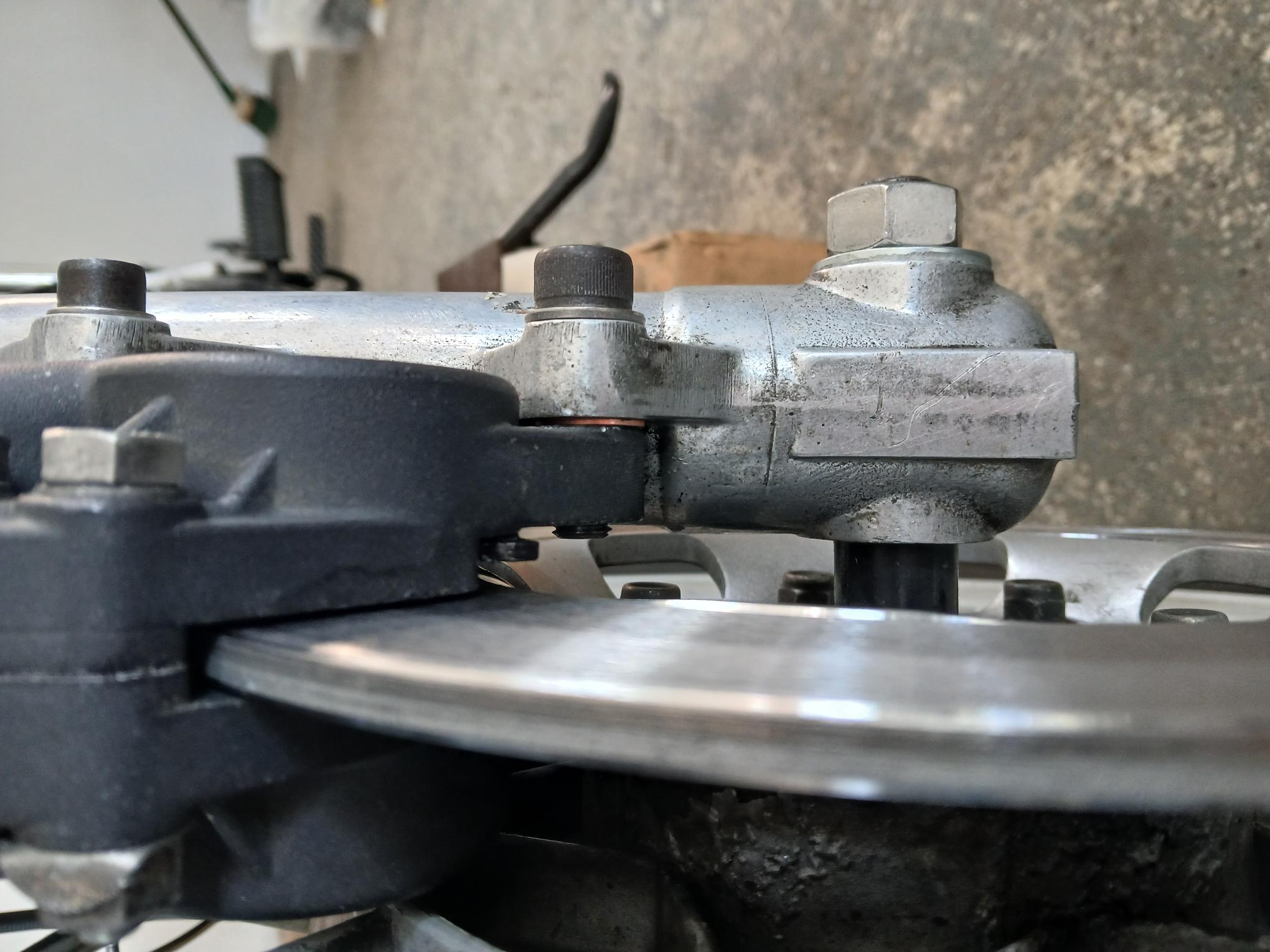

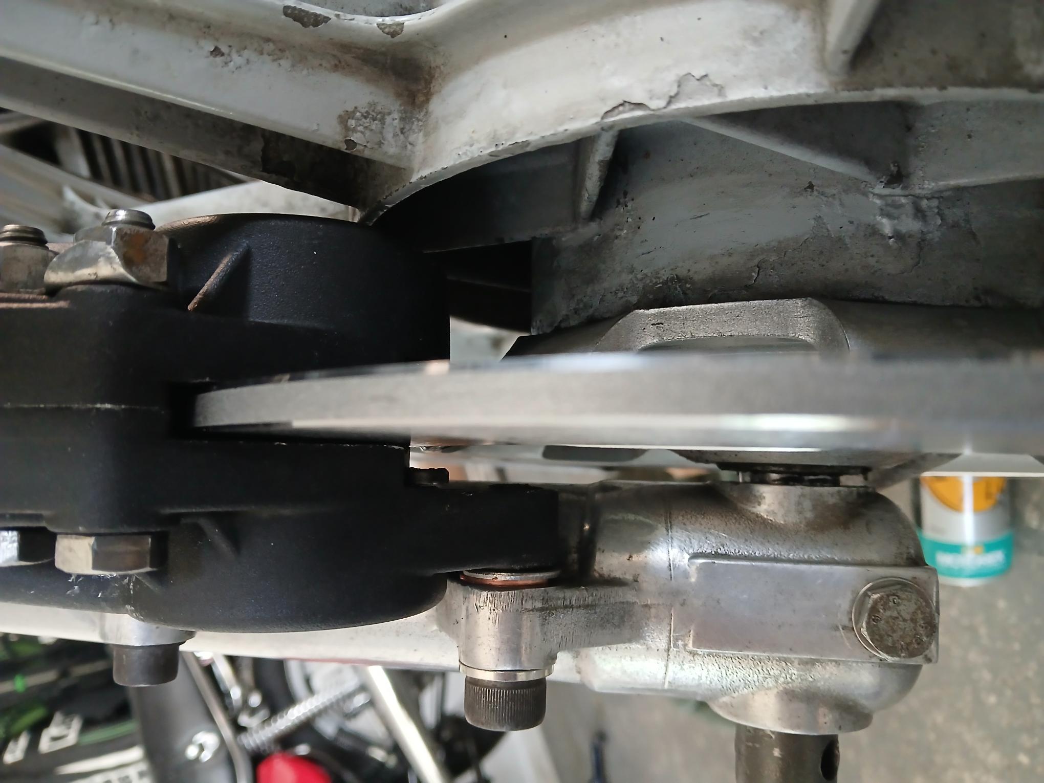

Re: Brake discs
Well, thanks for all the suggestions, and special thanks to Dickyboy for allowing me to compare his bike to mine even to the the inclusion of removing bits of it for me!
Happy days as I can report the pulsing braking has been completely cured.
In the end what sorted it was using some thin washers to shim the gap on the lower mounting point between the calipers and the fork legs. You can see the copper washers in there.
I'm not sure whether there are actually supposed to be any shims/washers/spacers in there but it certainly seems to have solved the problem.
