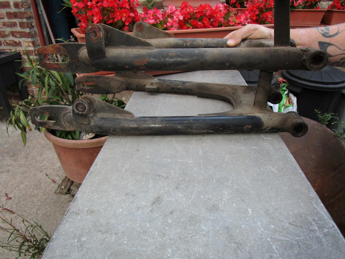

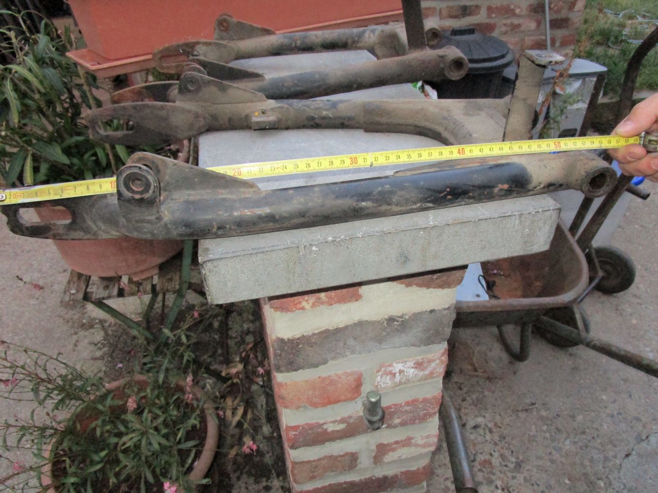

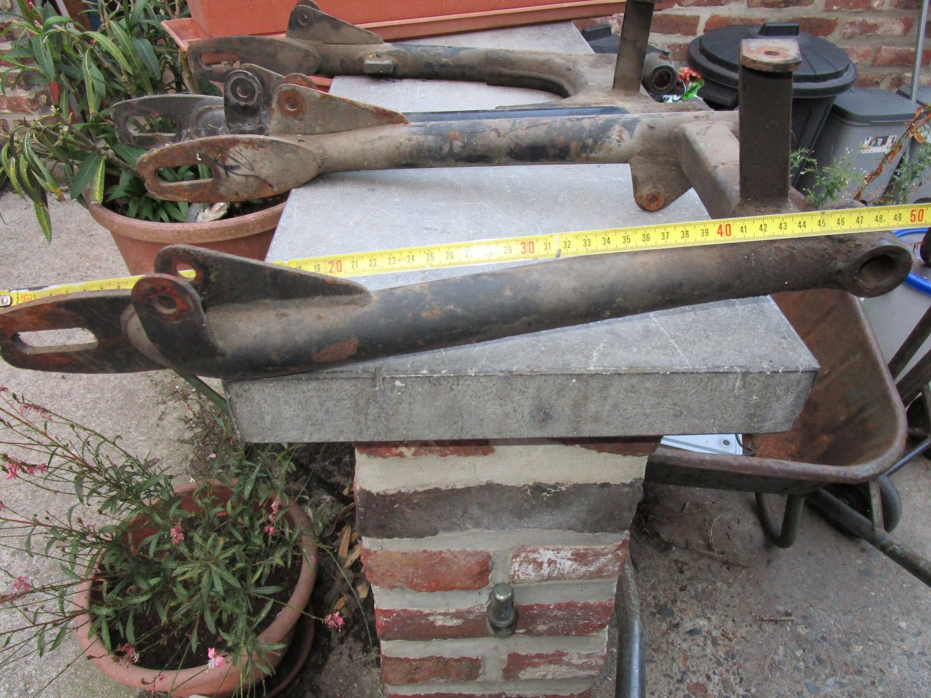

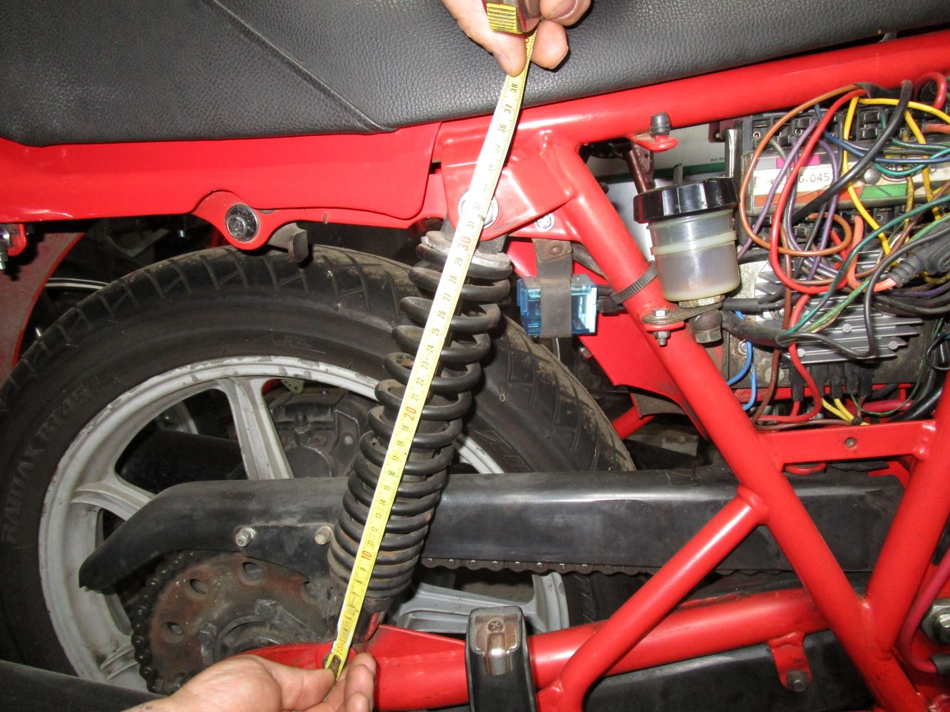

I just have a look at your subject . In fact 300mm between centers are only for 350 .
On the 500 the rear fork is longer + or - 60mm compare to the 350 .
Than on the 500 the shocks the lenght is 320mm between centers .
Christian , 123 .
Top is from a 350 and of course the botom is from a 500 .
The lenght of a 500 .
And here the lenght of 350 .

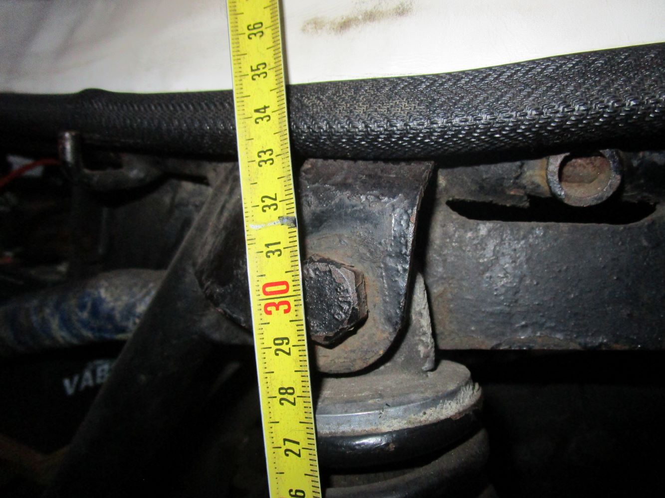

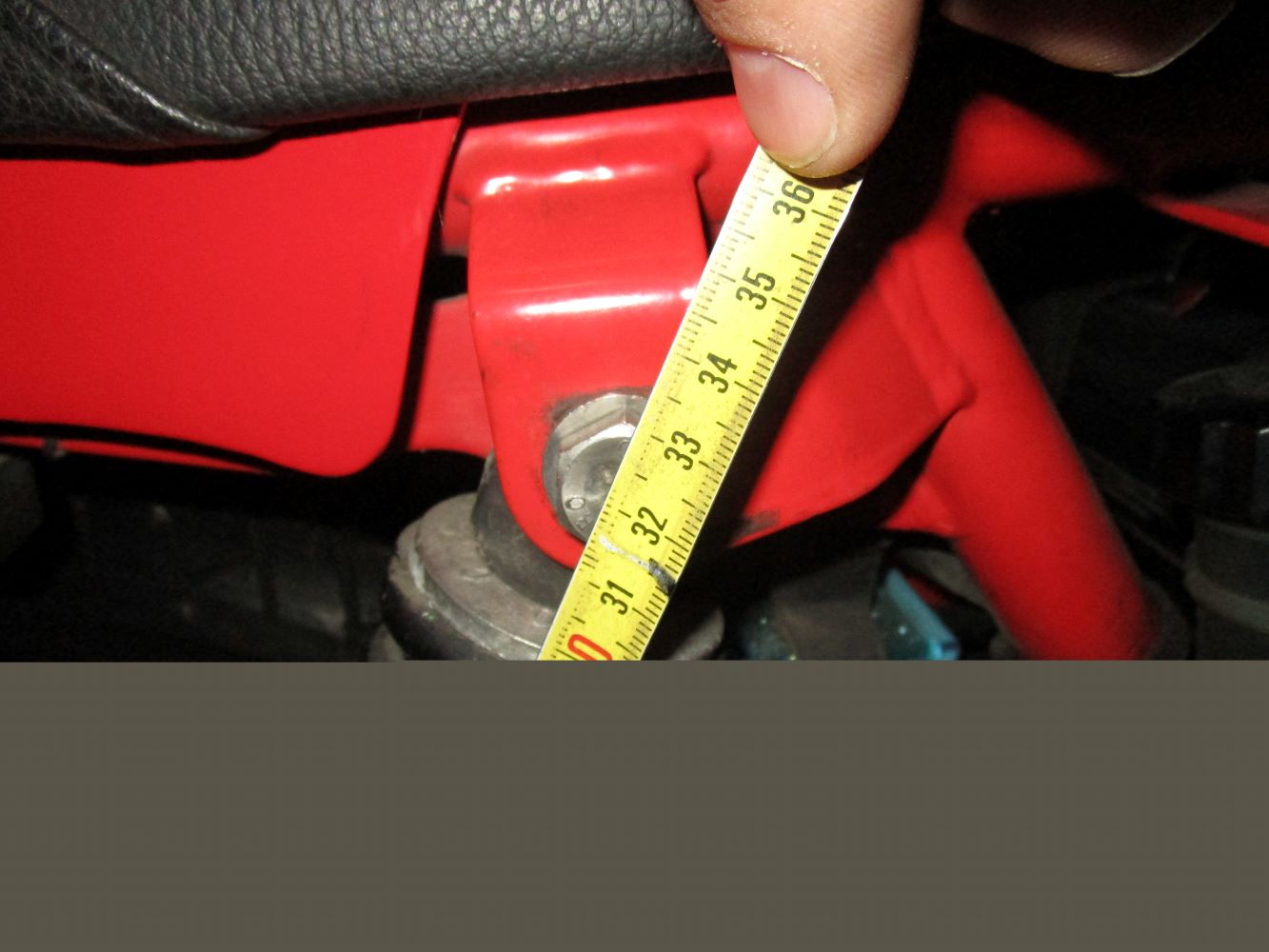

Re -
Here are photos of the lenght of shoks .
the 350
the 350
the 350
the 350
123morini
Posts: 43
Joined: 30 Nov 2015 12:19
Re: Rear shock absorbers - 300mm
Post by 123morini »

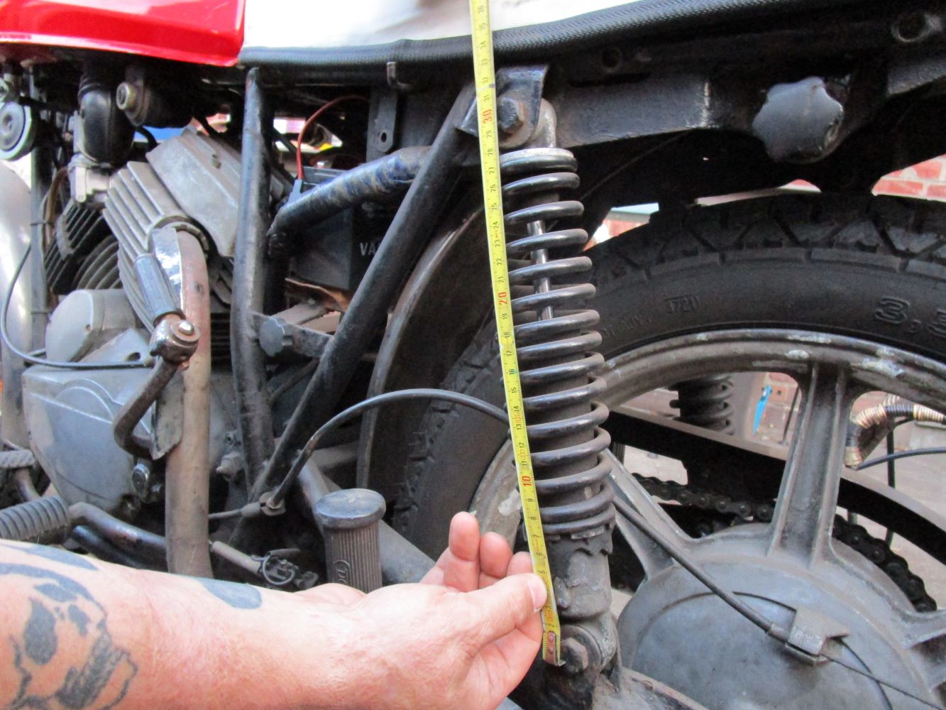

Re-re ,
The lenght of the 500 ...
Christian , 123 .
The lenght of 500
The lenght of 500
The lenght of 500
The lenght of 500

Nice to see the frame next to the brake fluid reservoir has not been damaged by brake fluid weeping.

Judging by other posts on the forum & my own measurements, something nearer 312mm eye to eye is correct for the 500
